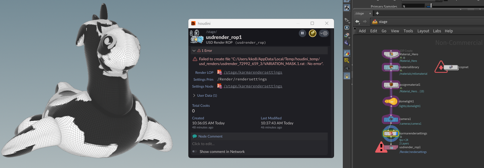

I have a super basic scene with a COP texture (triplanar projection), and I am getting errors I can't understand.
First, I get an error on the NULL node (VARIATION_MASK), which is set up as triplanar.
Maybe something is wrong with that setup, but then I have errors on the usdrender_rop1 node.
Tried without triplanar, and I can't even render VARIATION_MASK_FLAT, which is just a fractal nose.
I get issues displaying textures in the viewport; sometimes it works, sometimes not; changing the path to texture "op:/something" >> "op:something" helps or breaks.
I jsut stared to dig into COPs and am confused about what's going on. Maybe someone can take a look at my scene cop_snippets_001.hipnc and find an issue?

Ok, I noticed that the error happens if you set up material X with COP textures and then rename COP network.
Unable to fetch texture file from COPs: op:/stage/DIRT_MATERIAL_maps/VARIATION_MASK[1]
This DIRT_MATERIAL_maps was renamed and start throwing errors. Any way to fix that?
