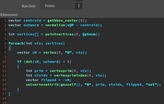

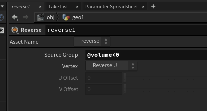

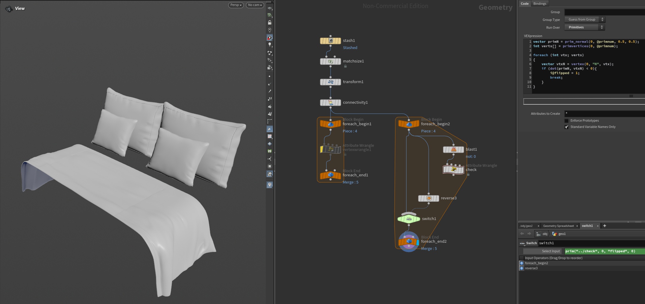

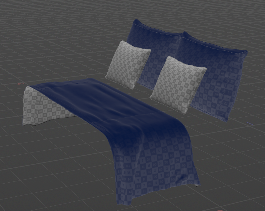

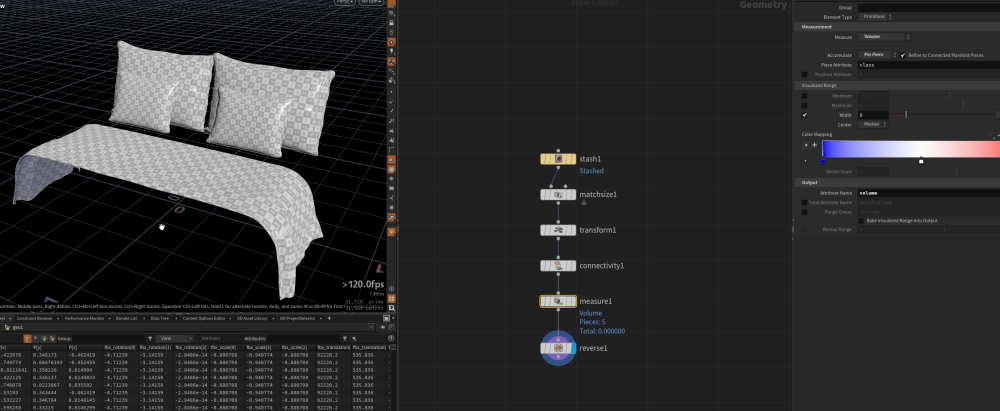

I have an asset that I imported into Houdini that has pieces with reverse Vertex Normals inside a for each loop per connected piece node, I have written a vex code that finds their bbox center of a piece and tries to determine which pieces get flipped according to the dot product of the point positions and the the bbox center point and have gotten no result out of it :(
And this is what I could come up with for islands with volume. I have absolutely no idea as to how to handle flat plane like structures. Maybe compare their vertex normal orientations to the centroid of the entire enclosure? But then again my code doesn't do the job :(
Any help would be appreciated.
