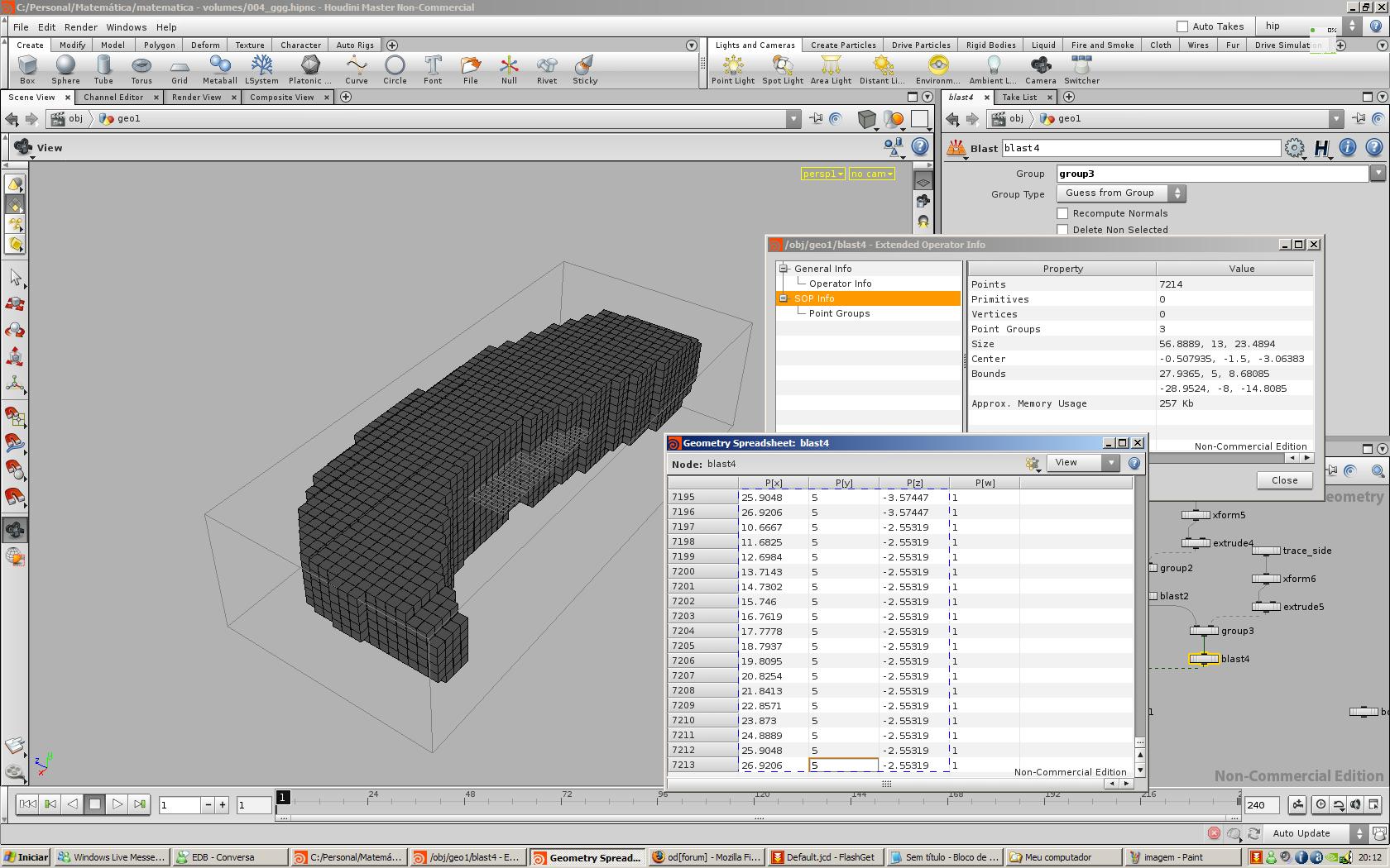

Andz Posted December 2, 2008 Share Posted December 2, 2008 (edited) Hi guys, I did this test for a school project in Houdini Apprentice. Is basically a proxy volume recognition from 3 photographs of fruits and vegetables. Does anyone know how , or if it is possible in Apprentice, to copy the points coordinates of this object so I can paste them in a spreadsheet? Maybe in the python shell or the textport? Thank you! Edited December 2, 2008 by Andz Quote Link to comment Share on other sites More sharing options...

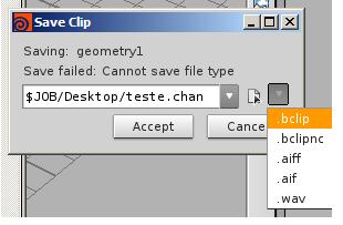

Andz Posted December 5, 2008 Author Share Posted December 5, 2008 (edited) I second the Geometry CHOP. Just rename your .chan file afterwards to .csv to read it into a spreadsheet program. These are the only file types I can save. I guess .CHAN is not available for the apprentice. **EDIT** And the funny thing is, I'm able to export the geometry in lots of file types OBJ, DXF, RIB, etc. in this apprentice version So, since my geometry is just points, I was able to open the OBJ in open office spreadsheet with coordinates perfectly placed in x,y,z columns. Thank you for the help guys! Edited December 5, 2008 by Andz Quote Link to comment Share on other sites More sharing options...
