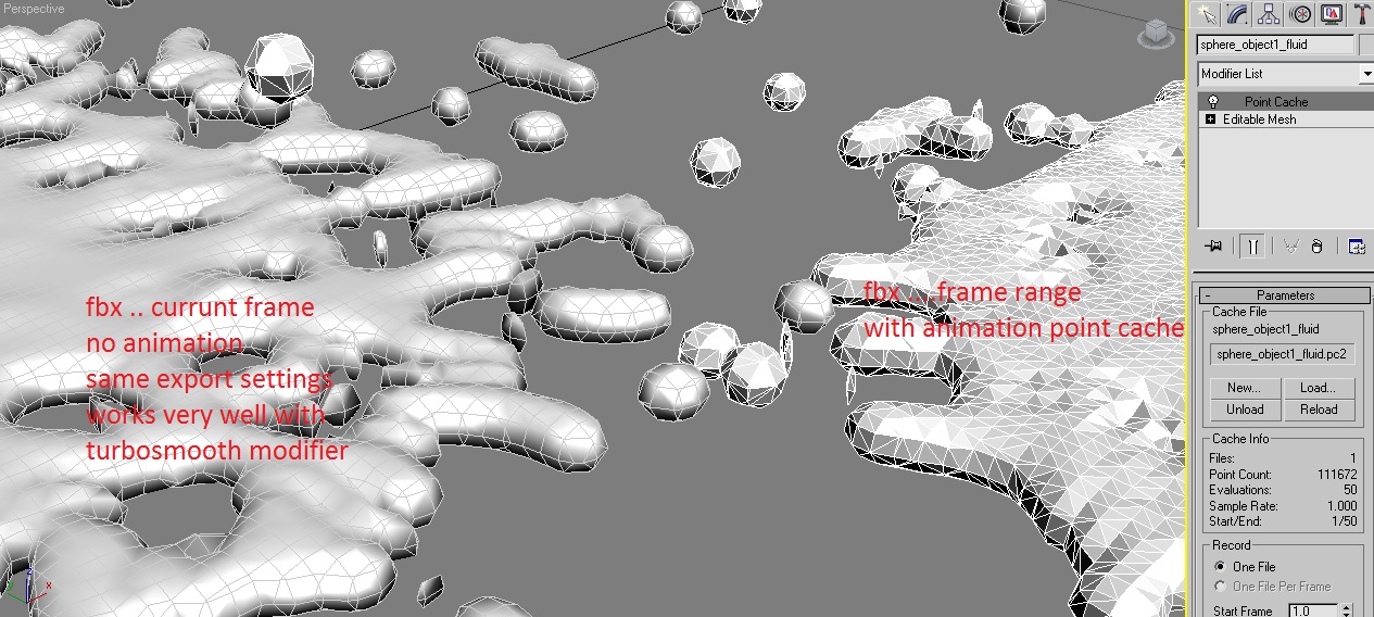

doctor3d Posted November 8, 2010 Share Posted November 8, 2010 (edited) Hi all I'm new to houdini I'm learning slowly I intend to use houdini in dynamics simulations use it with 3ds max i have a problem in exporting fbx ...the meshes isn't smooth like the way it appears in houdini .. its not polygons its Triangles and it seems very hard surface even with turbosmooth 2 levels is it a proplem from export settings or what ? Edited November 8, 2010 by doctor3d Quote Link to comment Share on other sites More sharing options...

doctor3d Posted November 10, 2010 Author Share Posted November 10, 2010 Did you possibly export a geometry without normals or with incorrect ones ? If this is the case add a facet sop (and check post compute normals) before exporting. Or add a edit normals modifier in max, and reset or unify (I don't remember the exact term). Then add smooth modifier and chose your smoothing angle (tri or quad it doesn't matter). not working i tried facet node .. same result I tried normal modifier and problem still the same and its not normals issue .. I normals issues in max turn completly black i tried import fbx in softimage xsi and even imported fbx back to houdini the faces are triangles Hey I have tried to export as a OBJ from Houdini to Maya and it is working, but if you import it back from Maya and try to export it again, it is not working. FBX is not working me at all, it comes in Maya as an empty locator. sorry but am not using 3dmax Cheers the problem is obj. doesn't carry animation that's the issue but fbx work with me very well in one frame export attached 2 fbx exports one current frame and the other is frame range and they are the same settings Quote Link to comment Share on other sites More sharing options...
doctor3d Posted November 10, 2010 Author Share Posted November 10, 2010 with some searches I found some answers the problem is they programed fbx to act this way the vertex is separated ..isolated from each other in animation export I applied vertex weld and it worked but so heavy ..I don't know why and its only a drop of water..! I didn't try the weld option in maya yet. I found a script load obj seq. to max http://www.scriptspot.com/3ds-max/scripts/objloader-v1-4 sorry had to ask this how I export obj seq. animation from houdini I didn't find it in export settings ? Quote Link to comment Share on other sites More sharing options...
