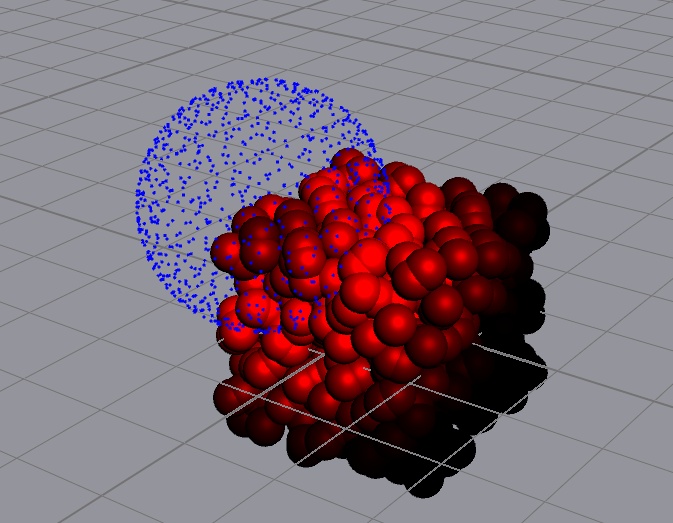

papicrunch Posted December 1, 2010 Share Posted December 1, 2010 hi, I try to simulate a sort of scattering effect by calculating the distance of one point to others, then transfering those distances to the color of those points. In vopsop i have found a solution by using the distance vop but I need to stack in the same location, the same numbers of points who i want color. Is there an other solution by using only point for the calculation ? here an hip file where you can see all the scattering point stalked on the little sphere to simulate the same location. Thank you, Papi transferDistance.hip Quote Link to comment Share on other sites More sharing options...
Emanuele Berti Posted December 1, 2010 Share Posted December 1, 2010 Yes, here you are... the attachment should solve your issue. Cheers, Emanuele transferDistance_onePt.hipnc Quote Link to comment Share on other sites More sharing options...
papicrunch Posted December 2, 2010 Author Share Posted December 2, 2010 thank you Emanuele, so simple ... papi, Quote Link to comment Share on other sites More sharing options...
