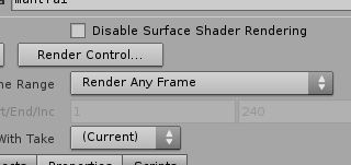

sanostol Posted April 17, 2011 Share Posted April 17, 2011 hi, You can add the paramater "shop_disable_surface_shader" to the ROP to force mantra not to use any surfaceshaders. now you can render at least the depthshadow without overhead. to still render color (maybe with textures) and no beauty, I'm not sure how that should work Quote Link to comment Share on other sites More sharing options...
m89 Posted April 17, 2011 Author Share Posted April 17, 2011 hi, You can add the paramater "shop_disable_surface_shader" to the ROP to force mantra not to use any surfaceshaders. now you can render at least the depthshadow without overhead. to still render color (maybe with textures) and no beauty, I'm not sure how that should work Hi, thanks for getting back to us so quickly, could you clarify what you mean by "shop_disable_surface_shader", is it an actual node, or something you have to set using the parameter node? As we couldnt find it in the ROP level. Sorry if this is a really a stupid question, this is the first time we've used houdini for rendering. Thanks m89 Quote Link to comment Share on other sites More sharing options...
Macha Posted April 17, 2011 Share Posted April 17, 2011 (edited) shop_disable_surface_shader will not disable all surface shading but will remove color, reflection and such things (not displacement, there is a separate parameter for that). So, you end up with a minimal "beauty" shader. I don't know how to completely remove it, except setting matte shading. disable.hipnc Edited April 17, 2011 by Macha Quote Link to comment Share on other sites More sharing options...

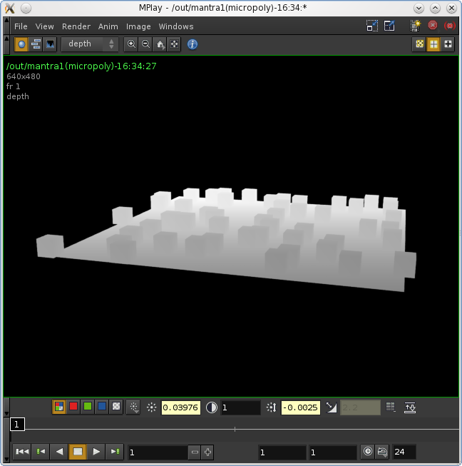

lukeiamyourfather Posted April 28, 2011 Share Posted April 28, 2011 Thanks for your help, we managed to do a colour pass using a take, and rendering off by using a constant shader with the texture applied, but we are still having difficulties with the depth pass. Still not too sure about how to do this Thanks again m89 See the attached scene and images. Note the extra image plane on the output tab of the Mantra ROP node. The shader is in the SHOP network, note the parameter node with the name of depth and export enabled. depthChannel.hip Quote Link to comment Share on other sites More sharing options...

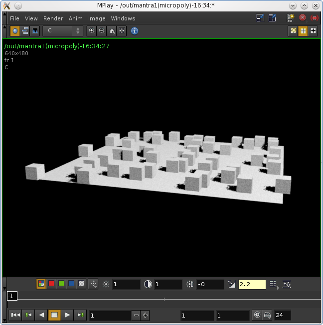

Erik_JE Posted April 29, 2011 Share Posted April 29, 2011 shop_disable_surface_shader will not disable all surface shading but will remove color, reflection and such things (not displacement, there is a separate parameter for that). So, you end up with a minimal "beauty" shader. I don't know how to completely remove it, except setting matte shading. Just wanted to say how super handy this is for making ambient occlusion passes and I did not know about it until i stumbled upon this thread. Quote Link to comment Share on other sites More sharing options...
