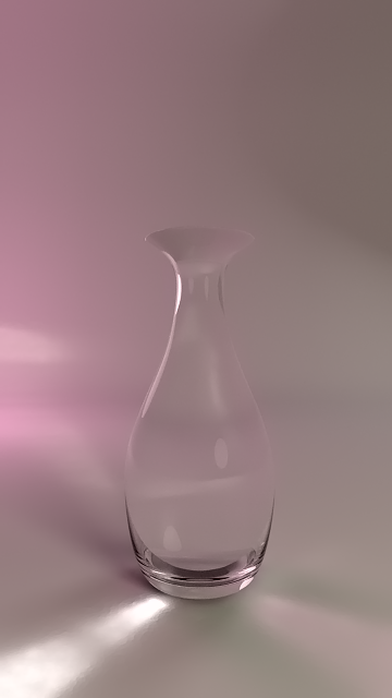

Rvb Posted December 22, 2011 Share Posted December 22, 2011 Hello all, In the image below you can see an image I just rendered. Every piece of glass that I render has a ugly bottom (when it stands on the ground). How can I fix this? I think it has something to do because the glass is so close to the ground the light-bounces aren't properly rendered. I hope someone can help me out! Kind regards, Rogier Quote Link to comment Share on other sites More sharing options...
hatrick Posted December 22, 2011 Share Posted December 22, 2011 could you tell us a bit more about your render and shader settings... and what do you mean with "ugly bottom"? increase you refractionsamplecount ? increase your reflectionsamplecount ? check your environment ? increase samples for the caustics ? cheers HT Quote Link to comment Share on other sites More sharing options...

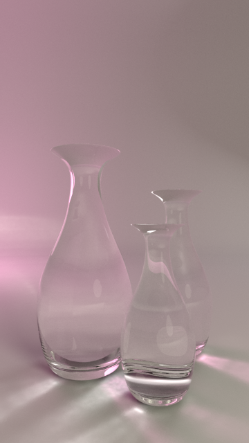

Rvb Posted December 22, 2011 Author Share Posted December 22, 2011 So I've increased the reflect and refract limit to 25 and used 3 million photons and the result is better than before! Although somehow it still looks a bit strange. Here is a quick render I made. I really love my new Intel 2600K @ 4,9Ghz, rendertime was about 5 min. 8x8samples and 0.01 noise level Quote Link to comment Share on other sites More sharing options...
Macha Posted December 23, 2011 Share Posted December 23, 2011 I think you should forget the rendersetting for a while and concentrate on the photon filter samples. See the photons in the viewport (load as geometry) and check if they are too dense/sparse or have some other oddities. Quote Link to comment Share on other sites More sharing options...
Erik_JE Posted December 23, 2011 Share Posted December 23, 2011 Depending on scene scale. Look into Raytracing bias. If your object is not that big and your bias is set to default it might make some strange stuff with thin refractive materials. As well tho if you set it too small it will also do strange stuff. Quote Link to comment Share on other sites More sharing options...
