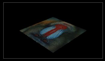

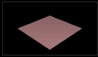

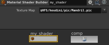

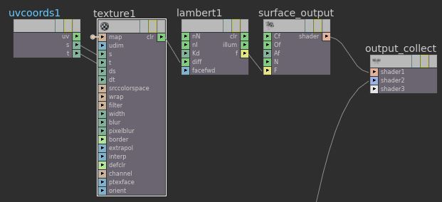

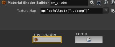

galagast Posted February 18, 2016 Share Posted February 18, 2016 Hi, I've followed this method before, but for some weird reason, it doesn't seem to be working (H15.347).. or I may have just missed something really simple. I have a grid, with uv texture: In SHOPs, I created a simple Material Shader Builder network, the Texture VOP's Map is the only parameter exposed. Also in SHOPs, I created a COP network. I then set the shader's texture map to point to the COP using: op:`opfullpath("../comp")` Inside COPs, I have a simple File COP set to load the default Mandril.pic I assigned the material to the Grid object then lastly, I rendered the scene. ------------------------------------------------------------------------ But if try and directly reference the Mandril image like so: $HFS/houdini/pic/Mandril.pic It renders fine.. What could I be missing? Attached below is a Houdini Indie file. H15_INDIE_COPS_in_VOPS.rar Quote Link to comment Share on other sites More sharing options...
