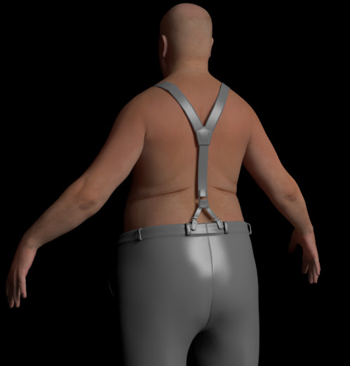

abvfx Posted November 9, 2012 Author Share Posted November 9, 2012 Do you feel more comfortable Joking aside, I was thinking of doing a surreal scene set in the 60's of him on the edge of a diving board looking at the camera about to jump into a pool infested with sharks. Lots of Houdini goodness Then it turned into an exercise but i still might do it. I'm using him as a benchmark for a lot of things at the moment. I had already made him a jacket that is just a quick snapshot of the lower half suit all of this in preparation for testing the cloth capture sop. But one step at a time now Quote Link to comment Share on other sites More sharing options...

abvfx Posted August 13, 2013 Author Share Posted August 13, 2013 Thanks Fabiano, Quick pass on the hair and eyebrows, (shoulda turned on the skin for the render here, oh well next time i guess ). Wasn't the most demanding in terms of grooming as you can see but still needed to sculpt the hair in blender as opposed to using point attributes in Houdini, the geometry is dense enough to control local sections but in terms of ultimate control, custom guides are needed. Color is point attribute based though. Gonna move onto the body hair (which will be all point attribute based) and clean up the other maps. Quote Link to comment Share on other sites More sharing options...
abvfx Posted September 6, 2013 Author Share Posted September 6, 2013 (edited) So here a a bunch of final-ish images. He is very deep in the uncanny valley, the one thing that really needs work is the eyes, I haven't even got an liquid eyeline layer or caruncle. The clothes don't have anything else but for a colour map. But i will call it a day for now, can't really stand to look at it, but i learnt a lot. Certainly gonna convert a lot of the work into assets ie the skin shader. And he will be used in my facial/general rigging tests along with cloth sims. When you are working with over 20 x 2-4k textures it can get quite tiresome. A few questions though, can I work with multi-channel exr/tif textures and convert those to rat, ie One texture would have colour, spec, gloss, displace and sss? What is faster? The headshot that you see in this post of hitch rendered in 14 minutes (8x8 pixel samples) but i can render him in 3 minutes (4x4) with little change in quality, (yes there is less grain but can it justify the time?). Any other tip to improve the render times? And im very open to criticism, any tips on what you think would make this better? Bodyhair render (shoulda fixed those nipples ) Clothes render (didnt know if i shoulda modeled wrinkles or not if i want to make it viable for a cloth sim, also not happy at all with the shader/look of it but oh well ) Headshot default mantra Couldn't resist doing a few grades And a base mesh wireframe if anyone wants it. Edited September 7, 2013 by phrenzy84 Quote Link to comment Share on other sites More sharing options...
