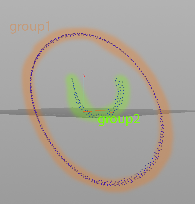

dpap Posted December 21, 2013 Share Posted December 21, 2013 Hi ! Is there a way to seperate this point cloud into 2 different groups? (one containing the points in green and one the points in orange) Thanks Group Not Connected Point Clouds Parts.hipnc Quote Link to comment Share on other sites More sharing options...
anim Posted December 22, 2013 Share Posted December 22, 2013 you can connect points by distance within some radius using attribwrangle and simple pointcloud loop with H13 new functions for geometry creation, you can either slightly alter Connect Adjacent Pieces SOP or just do very simple version (as in the included file) then just use Connectivity SOP and Partition SOP to get groups of connected point islands and Add SOP to keep just original points look at the file Group Not Connected Point Clouds Parts_fix.hipnc 2 Quote Link to comment Share on other sites More sharing options...
yesyes Posted December 22, 2013 Share Posted December 22, 2013 use bounding object and combine tab to get both groups 1 Quote Link to comment Share on other sites More sharing options...
edward Posted December 22, 2013 Share Posted December 22, 2013 Here's an example using what yesyes said and the new VFX hammer of choice, VDB. Group_Not_Connected_Point_Clouds_Parts_Using_VDB.hipnc 1 Quote Link to comment Share on other sites More sharing options...
