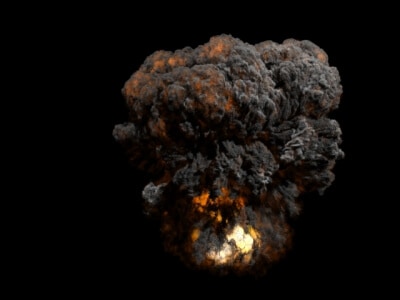

Juzwa Posted October 9, 2014 Author Share Posted October 9, 2014 (edited) Hi! Thanks tony but but I've already found what was wrong. I was using a volumelight with a pretty hight velue. Once I've got rid of it everything is ok. And since I'm not gonna render this with environment there is no point using volumelght right now. I've made some improvements on the shader and I'm pretty happy with the resault. However this is still far from high detailed pyro and this is now what I have in mind. I think I'm gonna start adding different sources now, and start mixing them to get some realistic resaults (on the sim). And then go back to the sahders. this is what i've rendered this morning: https://vimeo.com/108466699 And this is what i have in mind: The last one is from Igor Zanic ( this vid: https://vimeo.com/53774979 ) I have no idea how this detail is made of shader. This almost looks like some inverted ramp. Black color for fire at position 1, and then adding some lighter key for position 0.999. This is how close I can get for now: And I have fow questions for now: 1) How do I make my emitter to stop emit both fuel and smoke in AutoDopNetwork? When I change activation in Source Volume to 0 I dont get any more flames, but smoke is still beeing emitted. When I look at the fuel I see that it still exist when the activation is 0. So I make sense why density is still beeing emitted. I'm very confused. I know I can just scale the emitter to 0 to make sure there is nothing to emit, but it's gonna be pretty paint in the ass, when I start mixing emitters (particles and rbd) 2)Upres. I'm confused weather do write out lowres, upres, or both? I got used to fumefx, where you first calculate lowres and then do highres, and they both keep different data and store different files. Does houdini's upres work same way? If your have any tips for me I would be grateful ! Edited October 9, 2014 by Juzwa 1 Quote Link to comment Share on other sites More sharing options...
poppy Posted October 15, 2014 Share Posted October 15, 2014 Hi, I like your latest image. For controlling emitter, you could either keyframe (or $F==) on activation or source volume scale. For upres, I'm no expert, but H13's pyro was so powerful that you could go straight for hires. Or if you rly want to upres, you could use GasUpres node or shelf tool Up-res. And for SLR, I use Raytrace, I believe it faster than PBR for volume imho. Quote Link to comment Share on other sites More sharing options...
