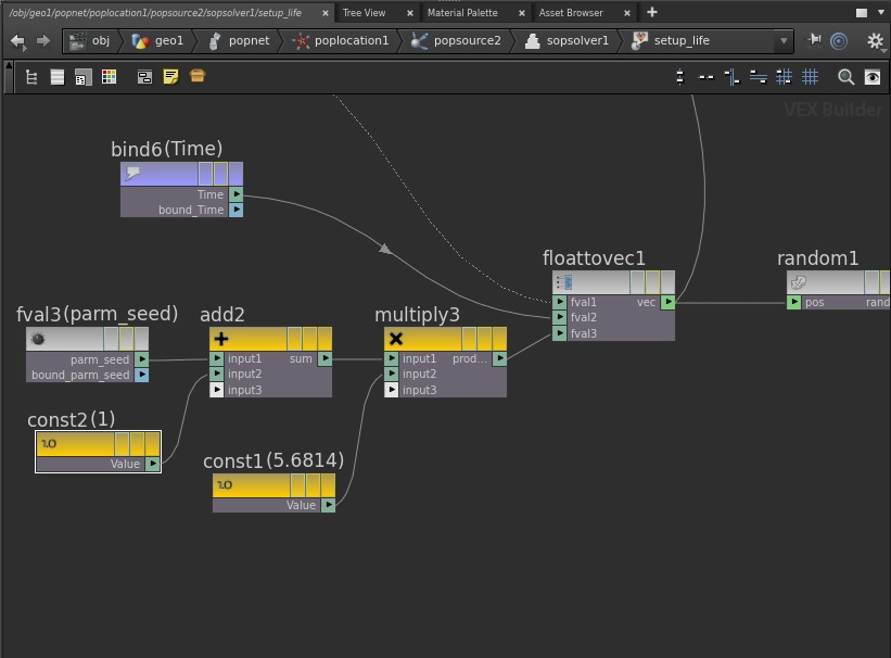

Ah I see. It seems to be related to the seed, and that the same seed is used everywhere (I guess). Diving into the POP Location DOP, into the "setup_life" VOP - alter or replace the seed so that it is unique.
post-9276-0-98626300-1432000099_thumb.jp
edit: Just noticed Jeff Lait answered the same on your crosspost over at sesi, so yeah this is definitely it.
