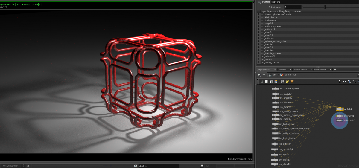

Atom Posted July 6, 2015 Share Posted July 6, 2015 I went ahead and played around a bit with trying out the formulas inside the iso surface node. Some of them work and some of them don't. But I could be mis-configuring the node. The MIN/MAX values seem to have a great effect upon what the formula actually generates. As the bounding box increases, the quality goes down unless you increase divisions. I have setup a few of the formulas with a switch if anyone wants to play around with them. I have replaced any sind/cosd with the appropriate sin(deg())/cos(deg()). ap_isosurface.hipnc 1 Quote Link to comment Share on other sites More sharing options...
