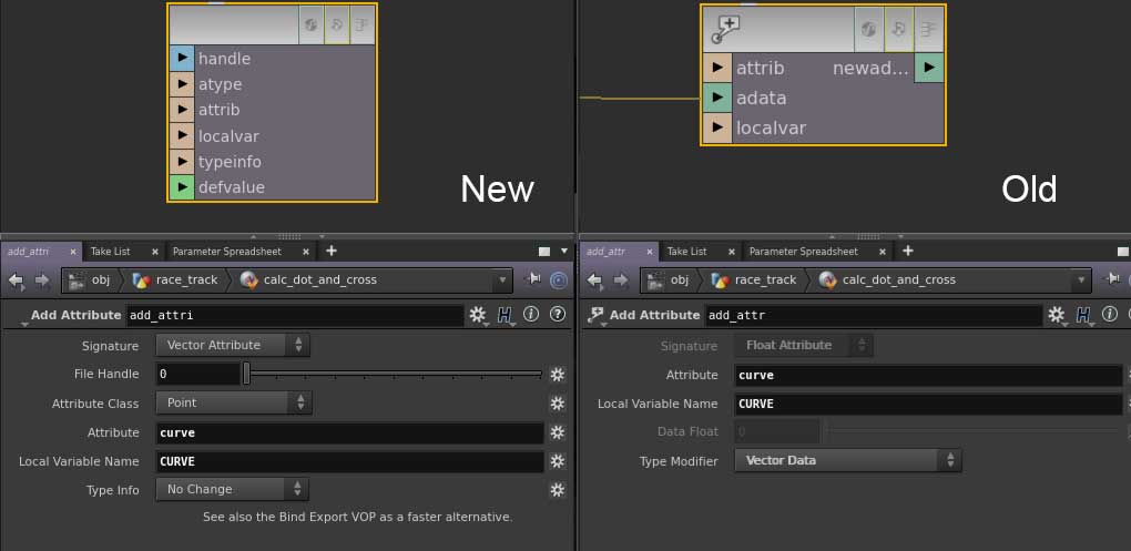

mosssi Posted August 20, 2015 Share Posted August 20, 2015 Hi everyone, I'm a new Houdini user and I have a question please: I want to use an "add attribute" node in "attribute vop" context but I don't know where to attach my float input correctly. I have a Houdini version 12 file that has this node with different inputs that I cant find in H 14 nodes. I tried to use "bind" node instead but there's no variable mapping in this node. can you please help me in this case. Quote Link to comment Share on other sites More sharing options...
jkunz07 Posted August 20, 2015 Share Posted August 20, 2015 The addattribute can create the attribute, set it's data type, default value, and mapping. The setattribute can then be used to set the values. You could also use bind instead of setattribute, but you would still need the addattribute to define the data type, default value, and mapping. Quote Link to comment Share on other sites More sharing options...

mosssi Posted August 21, 2015 Author Share Posted August 21, 2015 Thank you jkunz07, I searched for a whole day but I didn't found the point that the key was to use both add attribute and bind together. Quote Link to comment Share on other sites More sharing options...
