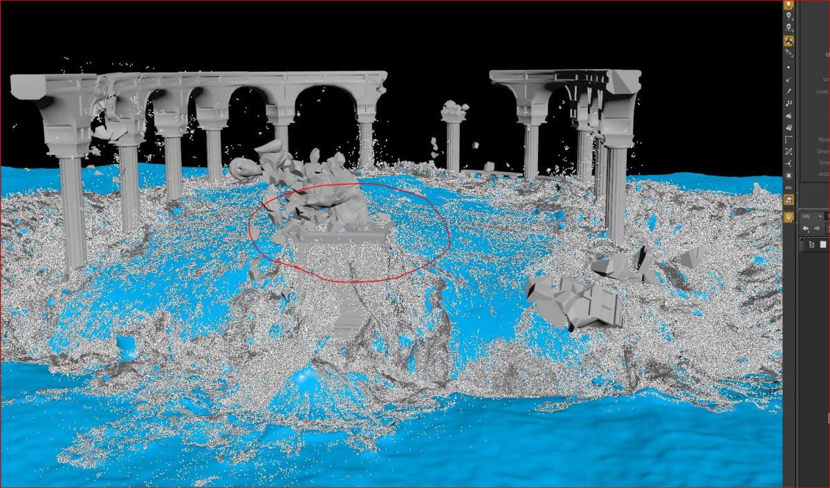

cudarsjanis Posted February 19, 2016 Share Posted February 19, 2016 Is there any way how I can mask out Ocean Evaluate Node`s influence in certain areas? I`m applying it to my flip fluid mesh and foam particles, but as you can see in this image, where the wave goes lower foam is coming from the geometry, which is something that i don`t want. Any suggestions? Thank you Quote Link to comment Share on other sites More sharing options...
johner Posted February 19, 2016 Share Posted February 19, 2016 (edited) The usual way is to handle the displacement yourself using the "restdisplace" output of OceanEvaluate. So don't feed your geometry into the OceanEvaluate, only leave the spectrum connected to the second input. Then on the volumes tab enable Rest Displacement. That will output three 2d volumes containing the displacement vectors. Finally use an AttribWrangle to do the displacement. Plug your geometry to be deformed into the first input and the OceanEvaluate into the second. The displacement is a one-liner: @P += volumesamplev(1, "restdisplace", @P); In that code you can scale the amount of displacement however you like. Edited February 19, 2016 by johner 1 Quote Link to comment Share on other sites More sharing options...
cudarsjanis Posted February 19, 2016 Author Share Posted February 19, 2016 The usual way is to handle the displacement yourself using the "restdisplace" output of OceanEvaluate. So don't feed your geometry into the OceanEvaluate, only leave the spectrum connected to the second input. Then on the volumes tab enable Rest Displacement. That will output three 2d volumes containing the displacement vectors. Finally use an AttribWrangle to do the displacement. Plug your geometry to be deformed into the first input and the OceanEvaluate into the second. The displacement is a one-liner: @P += volumesamplev(1, "restdisplace", @P); In that code you can scale the amount of displacement however you like. Thank you for the reply! I did all those steps that you wrote. But I have a question, how to gradually change displacement in certain areas now ? If I could change it for this area for 1-2 sec. that would be perfect. I`m quite new to Houdini, this is my first serious project in Houdini, been working on it more than month already. Quote Link to comment Share on other sites More sharing options...
