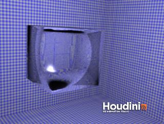

pld Posted September 21, 2005 Share Posted September 21, 2005 Hi All, I'm new to Houdini so this might sound an obvious thing... anyway, I'm trying to apply a VEX Glass shader to a cube. The cube is inside a larger cube which is textured with a checkborad pattern. When I render the cube I get black regions which I can't get rid of. I'm not sure if it's something to do with my rendering settings or a problem with my scene. I've tried to change some rendering parameters but no joy thanks for your help! Quote Link to comment Share on other sites More sharing options...
aracid Posted September 21, 2005 Share Posted September 21, 2005 hey i think u need to change ur reflect + refract bounce on the geo op, ie 10 or add a environment map too your glass shader hope this helps all the best aracid Quote Link to comment Share on other sites More sharing options...
pld Posted September 21, 2005 Author Share Posted September 21, 2005 Thanks aracid, I knew was something to do with refraction/reflection rays..Just couldn't find it under Mantra settings! Found it now in the geo op cheers Quote Link to comment Share on other sites More sharing options...
Jason Posted September 21, 2005 Share Posted September 21, 2005 Hullo, It also looks like you have "Consolidate Points" on your cube(s) turned on - which make them shade like spheres. This is why you're getting a bubble look in the refraction. Try turn that off and see if you prefer the results. Cheers, Jason Quote Link to comment Share on other sites More sharing options...
Marc Posted September 21, 2005 Share Posted September 21, 2005 I predict you'll probably still get black areas, 'cause the default glass shader is busted/wonky. M Quote Link to comment Share on other sites More sharing options...
pld Posted September 21, 2005 Author Share Posted September 21, 2005 Thanks for your answers...I noticed the bubble effect on other geometry too such as isosurfaces or even spheres. How would I disable this? Quote Link to comment Share on other sites More sharing options...
Jason Posted September 21, 2005 Share Posted September 21, 2005 Thanks for your answers...I noticed the bubble effect on other geometry too such as isosurfaces or even spheres. How would I disable this? 21413[/snapback] The FacetSOP (and EdgeCusp) will allow you to make sure edges are hard. Technically this makes the points along the edges unique (unshared). Quote Link to comment Share on other sites More sharing options...
