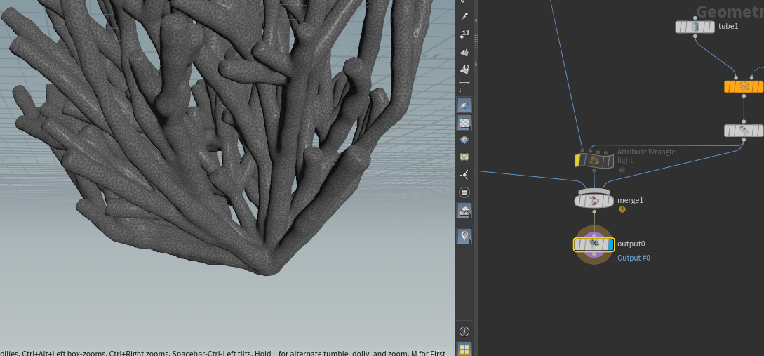

I would look into making a helix out of a curve. If your tree model has a skeleton or curve as a base I would use them otherwise you will have to make the curves manually. I think there are also some forum posts here on making a skeleton out of 3d geometry.

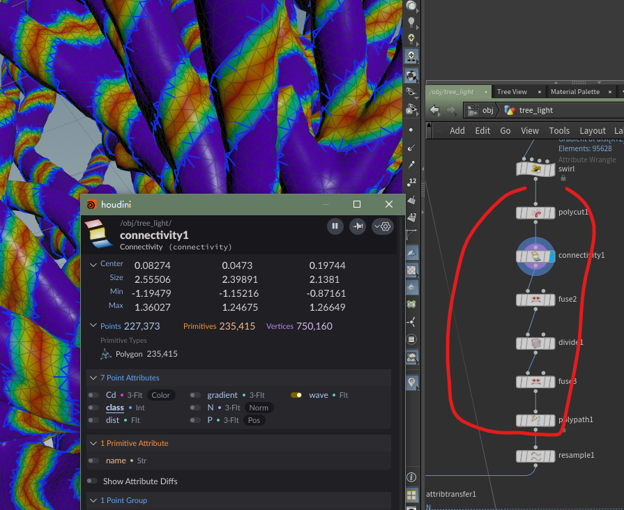

Hey Haya,
you could shift (and sine wave) the surface distance based on the surface orientation:
vector perp = normalize(cross(v@gradient, v@N));
perp *= dihedral(v@gradient, {0,1,0});
float angle = atan(perp.z, perp.x) / 2.0 + M_PI_2;
f@wave = sin((f@dist + angle * shift) * freq);
image.png.8772b19e743c3b38392f47bb15afffe2.pngimage.png.bbdb09355a0caf084f4db9fc3281e3af.png
tree_lights_simple.hiplc
