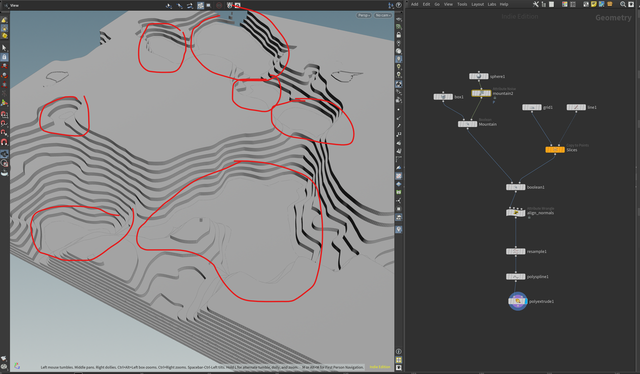

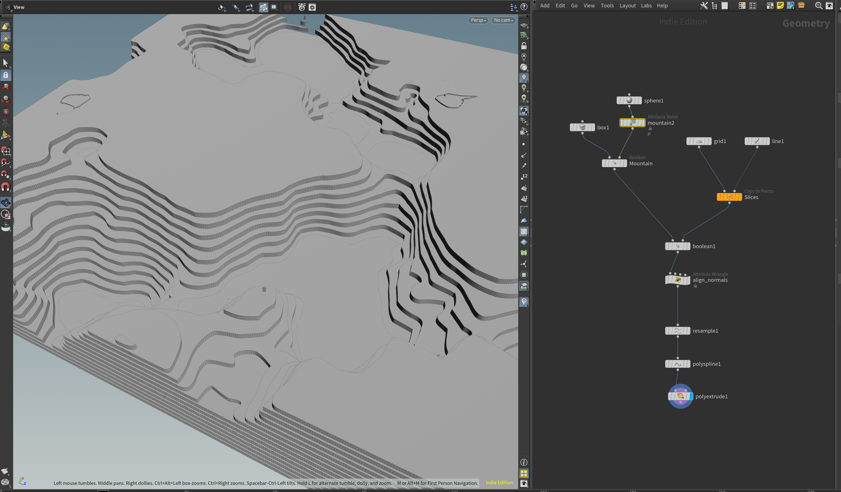

bratro Posted September 1, 2022 Share Posted September 1, 2022 Hi! I try to create some topographic maps like in these samples: I tried and came somewhat close to what I'm looking for but I'm not sure if that is the best way to do it. also the main issue here is, the layers which contains holes, won't be cut out. These are the marked areas which don't work correctly: What can I do to fix those holes or is there even a better solution to create this kind of effect? I would like to use some kind of noise so it can be animated later. Thanks for the help! sliced.hiplc Quote Link to comment Share on other sites More sharing options...
Librarian Posted September 1, 2022 Share Posted September 1, 2022 @bratro Here its One File ,also you can try to use Heightfiled then just bake to cops Height map of relief and Change pixel resolution you can make nice stuff. topof.hipnc Quote Link to comment Share on other sites More sharing options...
bratro Posted September 1, 2022 Author Share Posted September 1, 2022 @Librarian thanks so much for this setup, it really looks amazing! I haven't yet figured out how to make less steps. where can I adjust that? Quote Link to comment Share on other sites More sharing options...
Librarian Posted September 3, 2022 Share Posted September 3, 2022 @bratro 'inside foreach you have min o max steps' best to use Height-field tools if you don't need to have separate layers ...endless Fun. Quote Link to comment Share on other sites More sharing options...
