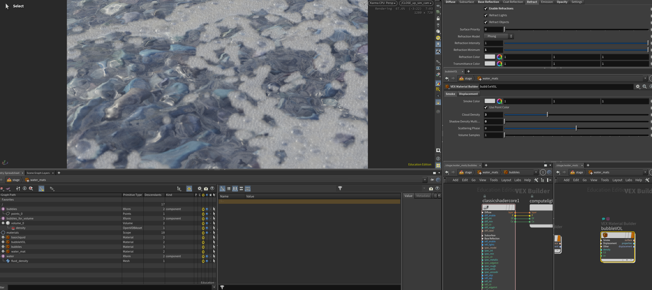

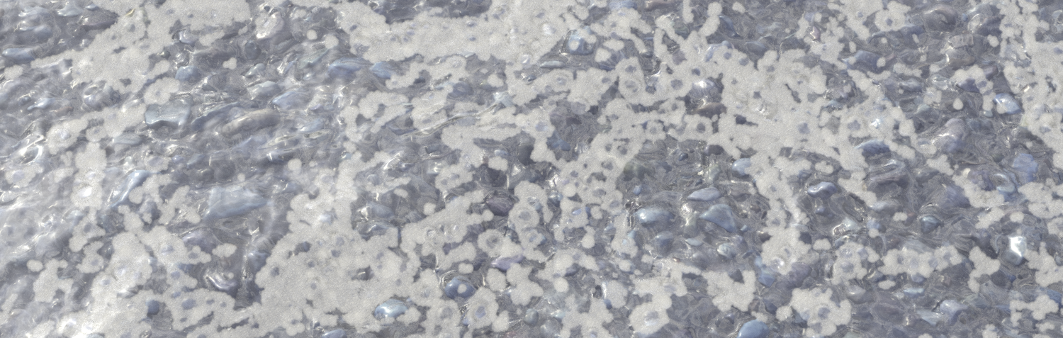

F_E_X Posted August 15 Share Posted August 15 (edited) On 5/2/2025 at 7:05 PM, tamagochy said: If you check the render over there you will see jittering/ also I checked scene there a lot of problems. Any way I found good solution it still need refining but works fast foam test Hi I‘m pretty much done with all dynamics, but I‘m struggling to get the bubble-foam material right. I use Karma cpu and I really can‘t manage to get the material correctly. My bubbles are just too specular, too bright and no matter what I change I dont get the look. Also a uniform volume brightens it up in a way I dont want. First I thought it may be my bright light and the bluish water, but no, its not and I have no idea what else I could tweak. dot product, specularity by pscale, diffuse by these attribs, all of this approaches weren’t successful. Do I need to switch to MtlX? For me its a pain atm and would appreciate some help. The trade between thin specularity and bright foam with dark holes seems so difficult and I find 0 resources on this topic. Thank you snippet-preview.mp4 Edited August 29 by F_E_X fixed it, just separating it and playing with shading settings video shows how close I am to finish the project hehe Quote Link to comment Share on other sites More sharing options...
