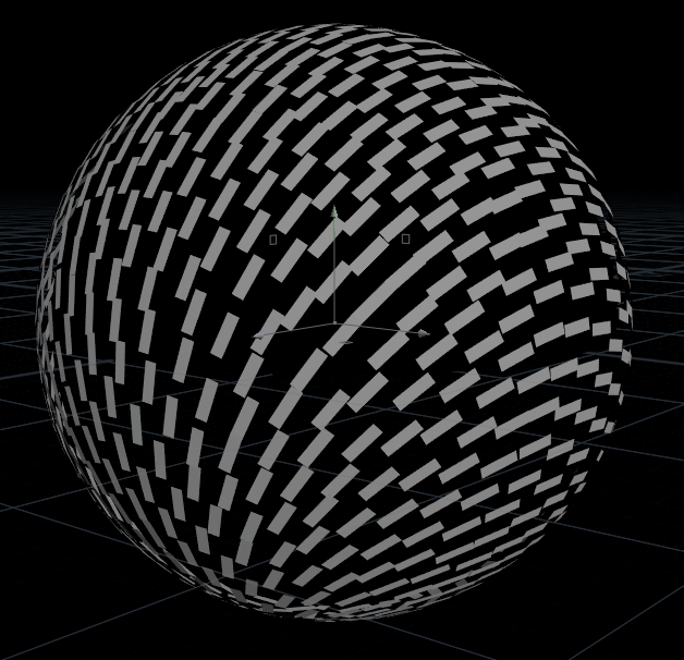

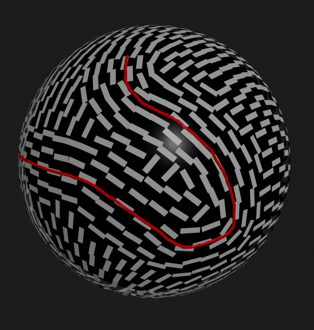

I'm using Scatter and Align, and I would like to drive the alignment with curves. Painting the normals with Comb SOP didn't work (at least I couldn't make it work).
How would you do this?
paint_alignment.hiplc

Maybe try with Target Forward Vector, a bit hard blend, for a smooth edge need to make something else.
The funny thing is that I tried the Target Forward Vector, but somehow failed to have success...
This method is really nice, thank you very much @fencer!
