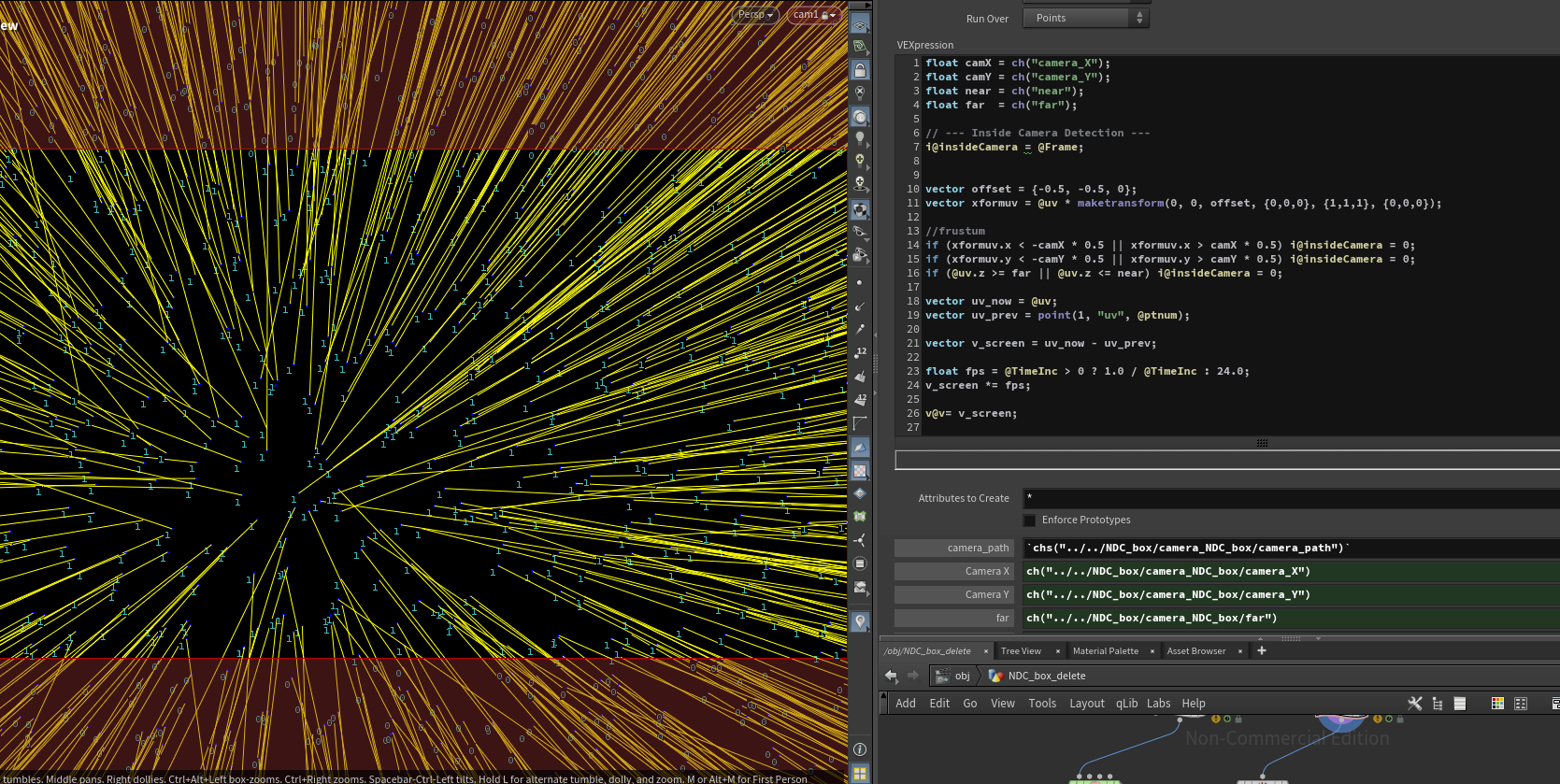

sipi Posted June 5 Author Share Posted June 5 (edited) This is what I could come up with. Uses 1 qLib node (Camera Plane ql). screen_space_velocity.hiplc Edited June 5 by sipi typo 2 Quote Link to comment Share on other sites More sharing options...

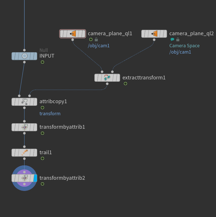

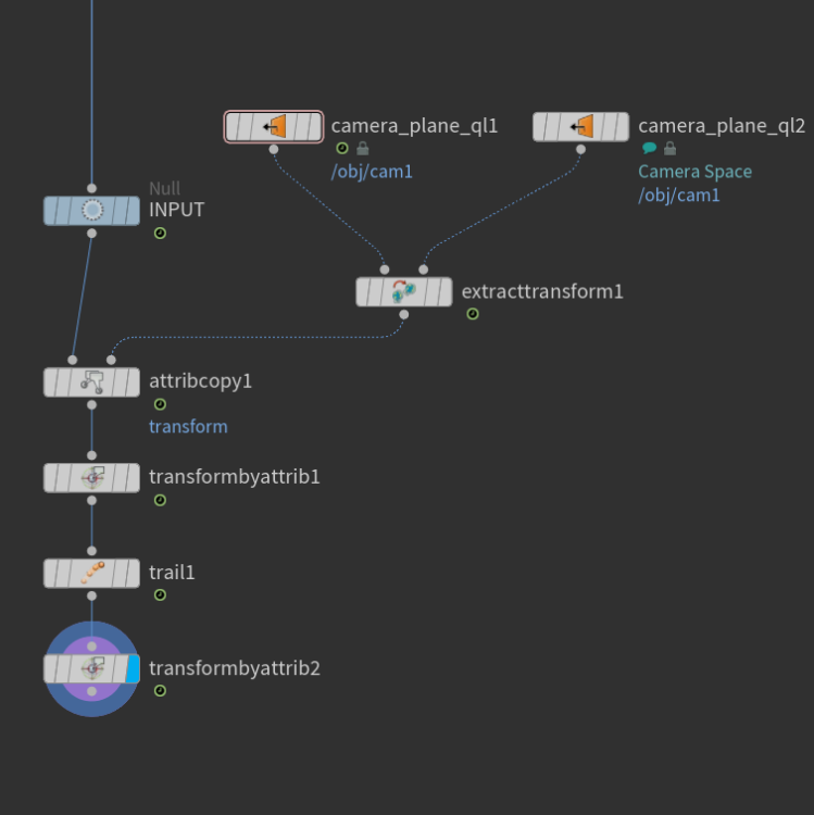

sipi Posted June 11 Author Share Posted June 11 I think I have found the perfect solution. This seems 100% correct. Takes into account the camera motion as well. screen_space_velocity_2.hiplc 2 Quote Link to comment Share on other sites More sharing options...
