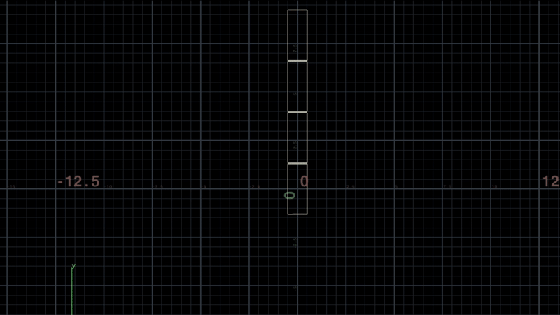

Masoud Posted August 26, 2025 Share Posted August 26, 2025 Hi everyone, I’m trying to offset some animated objects (just a few boxes) using CHOPs. I tried the Shift node, but as you can see in the image below, it doesn’t behave the way I expected. Any ideas what I might be missing? CHOP_03.hip Quote Link to comment Share on other sites More sharing options...
vicvvsh Posted August 27, 2025 Share Posted August 27, 2025 On 8/26/2025 at 4:40 PM, Masoud said: Hi everyone, I’m trying to offset some animated objects (just a few boxes) using CHOPs. I tried the Shift node, but as you can see in the image below, it doesn’t behave the way I expected. Any ideas what I might be missing? CHOP_03.hip 82.98 kB · 4 downloads Hi, on the Shift chop use expression: floor($C/24)*0.25 where 24 is 8 points of the box multiplied by 3 channel. 0.25 is speed multiplier. Quote Link to comment Share on other sites More sharing options...
