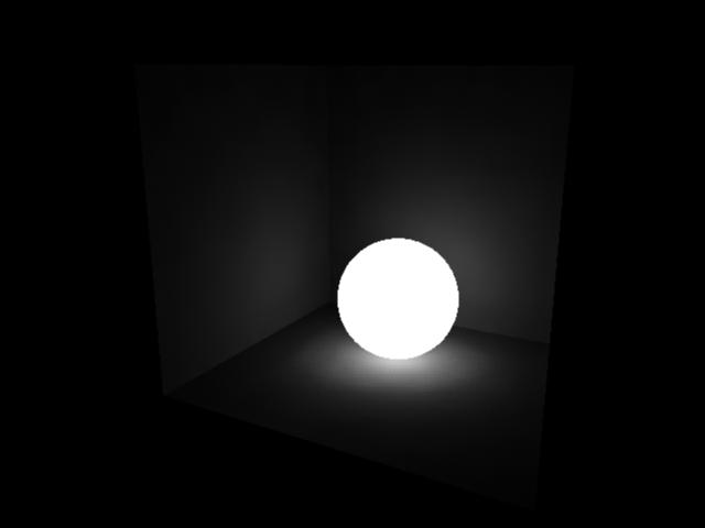

MENOZ Posted April 10, 2008 Share Posted April 10, 2008 hello, i'm trying to make an object that emit light. in mental ray from maya i know i can turn on final gather and use a surface shader on my object to make this effect. i post a image to show exactly what i mean. how can i do this in houdini? Quote Link to comment Share on other sites More sharing options...
kleer001 Posted April 11, 2008 Share Posted April 11, 2008 instance lights on scattered points. Quote Link to comment Share on other sites More sharing options...
Guest Swann Posted April 11, 2008 Share Posted April 11, 2008 Technique that I'm using I know from Modo. I create a little transparent object and in the middle I place point light. Quote Link to comment Share on other sites More sharing options...
stu Posted April 11, 2008 Share Posted April 11, 2008 If you're willing to use pbr, it'll work in exactly the way that you're describing - a constant shaded object will emit light by definition. Quote Link to comment Share on other sites More sharing options...
Symbolic Posted April 11, 2008 Share Posted April 11, 2008 If you're willing to use pbr, it'll work in exactly the way that you're describing - a constant shaded object will emit light by definition. Yeah... in PRB... a high diff value will make the object emit light. Quote Link to comment Share on other sites More sharing options...
Jordan Posted April 11, 2008 Share Posted April 11, 2008 hi, i still remember Dajuice did a lighbulb g.i. test scene sometimes ago. i set this scene up by looked at his scene file. here is the render. low sampling. here is the hip file. hope it helps. self_illluminated.hip Quote Link to comment Share on other sites More sharing options...
