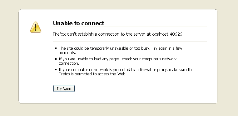

edward Posted May 1, 2008 Share Posted May 1, 2008 Have you looked at the online help? http://localhost:48626/rendering/volumetricrendering Quote Link to comment Share on other sites More sharing options...
Guest Swann Posted May 1, 2008 Share Posted May 1, 2008 Have you looked at the online help?http://localhost:48626/rendering/volumetricrendering This link doesn't work to good for me Quote Link to comment Share on other sites More sharing options...
stevenong Posted May 1, 2008 Share Posted May 1, 2008 If you click on Edward's link, it won't work unless you already have the Help browser started from Houdini. Cheers! steven Quote Link to comment Share on other sites More sharing options...
Guest Swann Posted May 1, 2008 Share Posted May 1, 2008 If you click on Edward's link, it won't work unless you already have the Help browser started from Houdini.Cheers! steven Now it works, and I don't have houdini browser open. Nevermind, I thought that this is some new info, and it's standard houdini help. Quote Link to comment Share on other sites More sharing options...
Bingo Posted May 1, 2008 Share Posted May 1, 2008 WOW!!the example showing in the link is very nice!!~~thank you all!! Quote Link to comment Share on other sites More sharing options...
stevenong Posted May 1, 2008 Share Posted May 1, 2008 Now it works, and I don't have houdini browser open.Nevermind, I thought that this is some new info, and it's standard houdini help. You don't need to have the Browser open, you just need to start the help server. After it is started, you can close the Help Browser & copy and paste http://localhost:48626/ into Firefox instead. Cheers! steven Quote Link to comment Share on other sites More sharing options...
