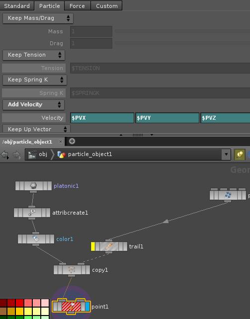

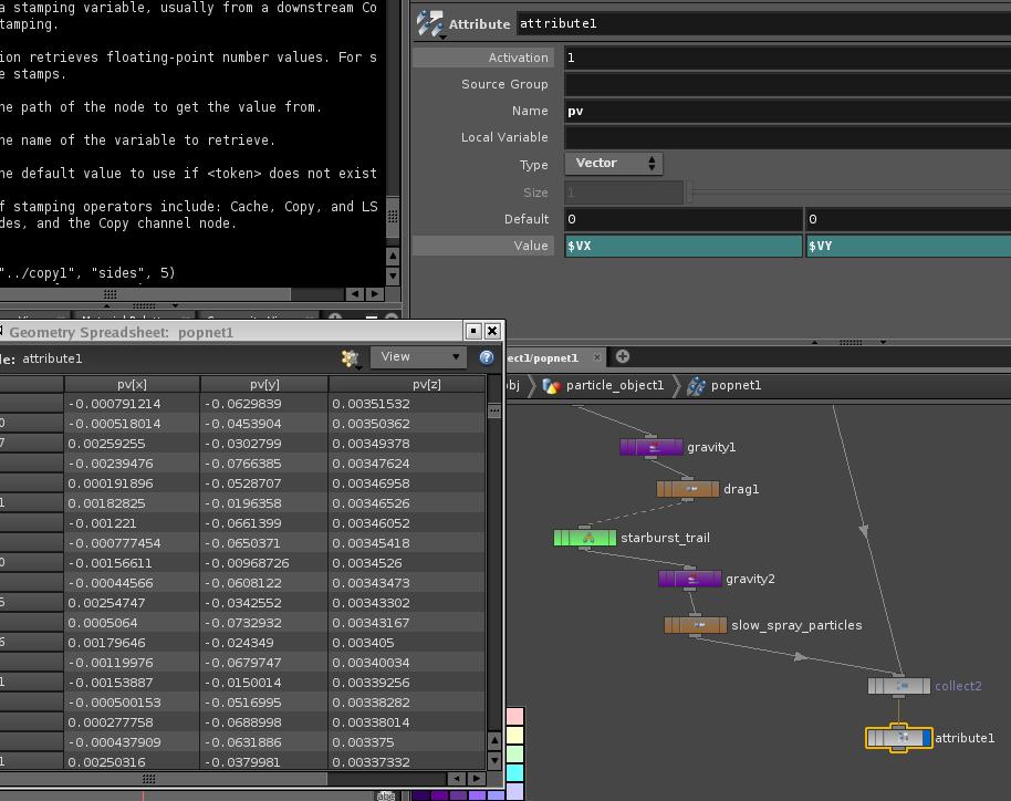

cloudfx Posted July 28, 2008 Share Posted July 28, 2008 (edited) Hi all, I 've done particle set-up for fireworks and trying to make motion blur. I used trail first time and it created strange velocity.. It looked okay in pop network but when I came out to obj network, the velocity start to go crazy.. So, I created attribute to export velocity of particle itself in pop network: And, I was trying to read that attribute in obj network, and I got error. I need help on this: Scene file:syndrome_fx_fireworks_002.hip Thanks. -j Edited July 28, 2008 by Jae Yoo Quote Link to comment Share on other sites More sharing options...
SpencerL Posted July 28, 2008 Share Posted July 28, 2008 (edited) your attribute "pv" is declared in POPs. You cannot access "pv" in SOPs using $PVX, $PVY, $PVZ. These are LOCAL variables which mean they are variables that only work within the context that they are created. In order to access this attribute in SOPs you would need to use a point expression, ie point("../popnet1", $ID, "pv", 0)... Edited July 28, 2008 by SpencerL Quote Link to comment Share on other sites More sharing options...
cloudfx Posted July 28, 2008 Author Share Posted July 28, 2008 (edited) your attribute "pv" is declared in POPs. You cannot access "pv" in SOPs using $PVX, $PVY, $PVZ. These are LOCAL variables which mean they are variables that only work within the context that they are created. In order to access this attribute in SOPs you would need to use a point expression, ie point("../popnet1", $ID, "pv", 0)... Hi, SpencerL. Thanks for replying. I did what you told me. I got this strange velocity. I know that it should work that way but dont, know what it the problem. Thanks, p.s scene file is provided up there. Edited July 28, 2008 by Jae Yoo Quote Link to comment Share on other sites More sharing options...
edward Posted July 29, 2008 Share Posted July 29, 2008 I'm not sure why you're trying to put the velocity into a separate attribute and then copy it back in the first place. You just need to use the parameters in the Attribute tab of the Copy SOP. Here's my attempt (without rendering). Some of your velocities at certain frames do look off but I think that's coming from your POP network itself. syndrome_fx_fireworks_002_edw.hip Quote Link to comment Share on other sites More sharing options...
