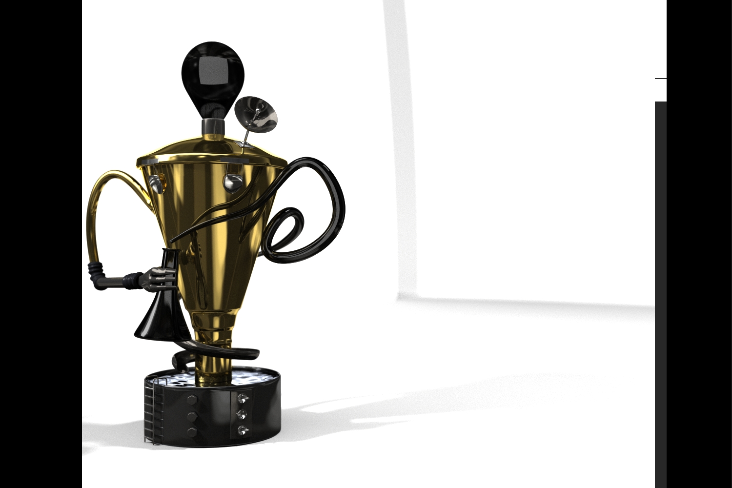

hatrick Posted March 22, 2009 Author Share Posted March 22, 2009 so .... would just no one use PBR rendering in my case ?? sorry again guys, but i just can not belive that my subject is that hard to solve for someone who knows mantra and it's shading methods... jason gave me some veryvery usefull tips but i need just a little more support. i m quite happy with some parts of the rendering but one big problem is the glass!!! it just looks .....?!?! the thing with the reflections of my white surrounding discussed in a preveous topic, i solved more ore less with phantom objects slightly translated over the ground ore the backgroundsphere with my envmap maped onto. for me that looks ok for the metalls .... but horrible with the glass... i m shure i make a lot of mistakes with the glass mat but i m on my wits end!! again i would need an option including ore exluding reflections ore light. so if someone is interested here are some pics and the hip again. impala_pokal_v4.hipnc Quote Link to comment Share on other sites More sharing options...

anamous Posted March 22, 2009 Share Posted March 22, 2009 I think that one major problem with the glass parts in your scene is that they aren't double sided, which means that they don't have a thickness and will always look funny (the light bulb on top for example looks like a glass ball, not like a bulb that consists of a thin glass wall and lots of vacuum inside - that is because your geometry doesn't have "walls", its just a volume of glass from one side to the other). Try using the peak SOP to create inner walls and reversing the normals on them, then merging the result of that with the current glass geometry. This will make refractions much more appealing. About PBR: the way it is in H9.5, you have to approach it thinking more like a photographer than a CG artist. As a photographer you have certain physical contraints of what part of your setup will show up as a reflection/refraction etc - the same applies to PBR in H9.5. It may be too much of a complicated task ATM - specially since I'm not actually sure what style you are going for. I would recommend staying with micropoly/raytracing for now, this way you can use the masking options and fake your way towards a pleasing image. As for rendering speed, you should be able to tweak the amount of raytracing bounces on the glass/metal materials to reduce render time. Also, tips like this and others ( like this for example) might help further. cheers, Abdelkareem Quote Link to comment Share on other sites More sharing options...
hatrick Posted March 22, 2009 Author Share Posted March 22, 2009 hi, in my last version i ve used the polyexrude SOP and normal reverse for my glas parts and their thickness .... the result was not that good.... but thx for your tips Quote Link to comment Share on other sites More sharing options...

hatrick Posted March 22, 2009 Author Share Posted March 22, 2009 could someone please check the orientation of my normals of the 3 glasobjects.... i m not completly shure bout that because the reverse sop does not take any effekt in the viewer.... i think its ok after subdivision of mantra.... thx impala_pokal_v5.hipnc Quote Link to comment Share on other sites More sharing options...
DaJuice Posted March 22, 2009 Share Posted March 22, 2009 The orientation is correct, but I think you made the glass objects much too thin (except for light bulb which seems about right). The thickness will of course have a big impact on the look of the glass. You can toggle on primitive normals in the viewport, and change their length to see better. Quote Link to comment Share on other sites More sharing options...
hatrick Posted March 22, 2009 Author Share Posted March 22, 2009 hey... finally i figured out a glassetting which makes my bulb look right i can not beleave how sensitive the meterial reacts... additionally i did some tweaks in the surrounding setup and it looks i can stay with PBR i thought that the bottle and the other glass object are to thick... i ll try the other way round..! Quote Link to comment Share on other sites More sharing options...
hatrick Posted March 22, 2009 Author Share Posted March 22, 2009 are not the point normals used for shading ? cause you ve pointed on the facenormals ... Paulaner Hefe Weizen.... i d love a houdiniwise nativ german contact ....Austria here Quote Link to comment Share on other sites More sharing options...

Jason Posted March 23, 2009 Share Posted March 23, 2009 thank you!i got close to the end ..... Nice! I have a sneaking suspicion that your Index Of Refraction (on your glass "arms") is inverted from what it should be. Is it 1.5 or so? The Material in Houdini really wants an inverted value for that (1/1.5 -- I actually hate this fact, I wish they'd just use the regular, well-know IOR values.) Also, your flask: it's shading as if it's solid glass. Is your glass thickness smaller than your ray bias? Quote Link to comment Share on other sites More sharing options...
hatrick Posted March 24, 2009 Author Share Posted March 24, 2009 (edited) interesting questions jason i ll check that .... i use the same glassshader on all glass objects Edited March 24, 2009 by hatrick Quote Link to comment Share on other sites More sharing options...
