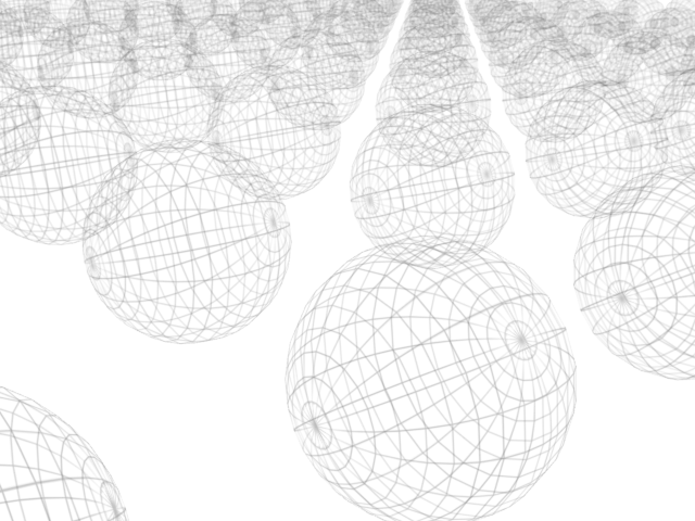

LaidlawFX Posted June 5, 2010 Share Posted June 5, 2010 the matteshadin substracts the alpha of one object from the alpha of another object deeper in z ... kind of intersection.... basicly exactly what i wanna do but without texture ore shader-opacity information...so still same probleme here thx I'm kind of confused with what you are asking. I rendered out these two copy stamped balls because I needed a visual, so do you want to be able to see through the back side of objects or not? and is this for texture space or like a z-depth channel for compositing? I could be completely wrong. A sketched out visual could help me. Can see backside of objects Can't see backside of objects Quote Link to comment Share on other sites More sharing options...
