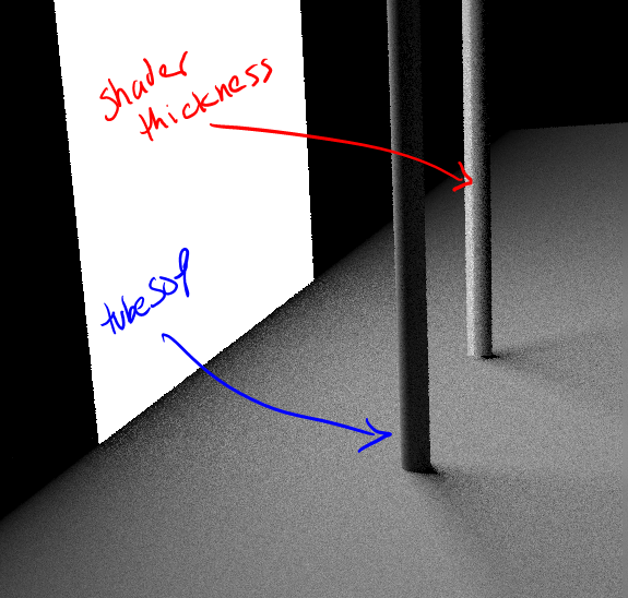

goldleaf Posted February 19, 2015 Share Posted February 19, 2015 I added a comparison to the shaded thickness to a tube sop (from that sidefx thread linked above). Hope it helps! curve_tube_modified.hipnc 1 Quote Link to comment Share on other sites More sharing options...
