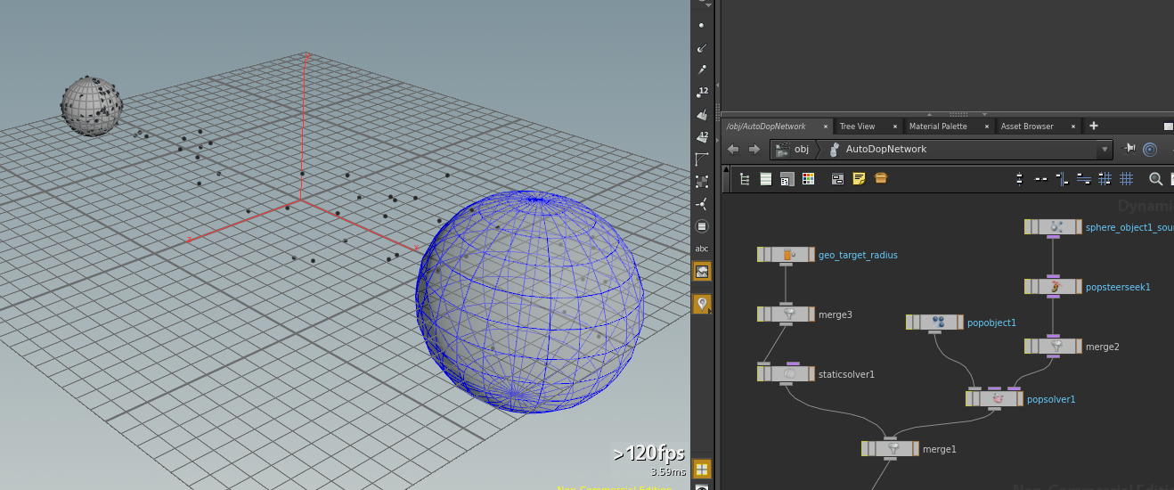

I have a sphere that I want to emit some particles.
I added a point into the scene, and I want to use that as my target visualizer for the particles direction.
also I want to add the feature so I can set a radius around the point to spread out the velocity a little bit.
Any ideas of how I can achieve this?
Cheers
Here is my interpretation of your concept. A sphere is parented around a point to act as a collider for the target location. Increase the radius as needed. The particles seek the target location because I pasted a relative reference to the point's location into the Goal field of the popsteerseek.
ap_particles_to_target_avoid.hipnc
