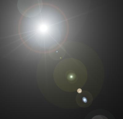

khasperha Posted September 14, 2006 Share Posted September 14, 2006 Hello everybody ! well i'd like to know if i can do a rendering lens flare in Houdini like lightwave? without do a composition. thanks. khasperha Quote Link to comment Share on other sites More sharing options...
Overload Posted September 14, 2006 Share Posted September 14, 2006 Never tried...but from prior and current experience, doing it in post/compositing is always best. Otherwise your pinned down to it, and may have to re-render if you don't like the outcome...which sucks Just my 2 cents.. Anthony Quote Link to comment Share on other sites More sharing options...
Moose Posted September 14, 2006 Share Posted September 14, 2006 There's a lensflare shader available from here - http://www.camf.com/ I haven't tried it, but maybe it's what you're after? Quote Link to comment Share on other sites More sharing options...
khasperha Posted September 14, 2006 Author Share Posted September 14, 2006 hey thanks for your answer Overload & Moose,hey Moose i 'll try to play with this shader... thanks again khasperha Quote Link to comment Share on other sites More sharing options...
symek Posted September 14, 2006 Share Posted September 14, 2006 heythanks for your answer Overload & Moose,hey Moose i 'll try to play with this shader... thanks again khasperha This shader is VEX version of Lary Gritz's RSL shader and as I remember was broken at some point. Is it ok now? cheers, SY. Quote Link to comment Share on other sites More sharing options...
mike Posted September 15, 2006 Share Posted September 15, 2006 it is still working... find enclosed the otl lensflare.otl Quote Link to comment Share on other sites More sharing options...
Overload Posted September 15, 2006 Share Posted September 15, 2006 Nice dude Quote Link to comment Share on other sites More sharing options...
bloogyct Posted July 25, 2016 Share Posted July 25, 2016 Hello, we are also investigating in render lens flare tools now, and I would like to check out the lensflare.otl linked by Michael. Anyone know if there are any docs to it - I have messed around a little, but am not getting much joy, either from it attached to the atmosphere/fog or to a volume generated from a sphere. Most I can get is a faint flow from a light when attached to a sphere volume. Thanks Sandy Quote Link to comment Share on other sites More sharing options...
