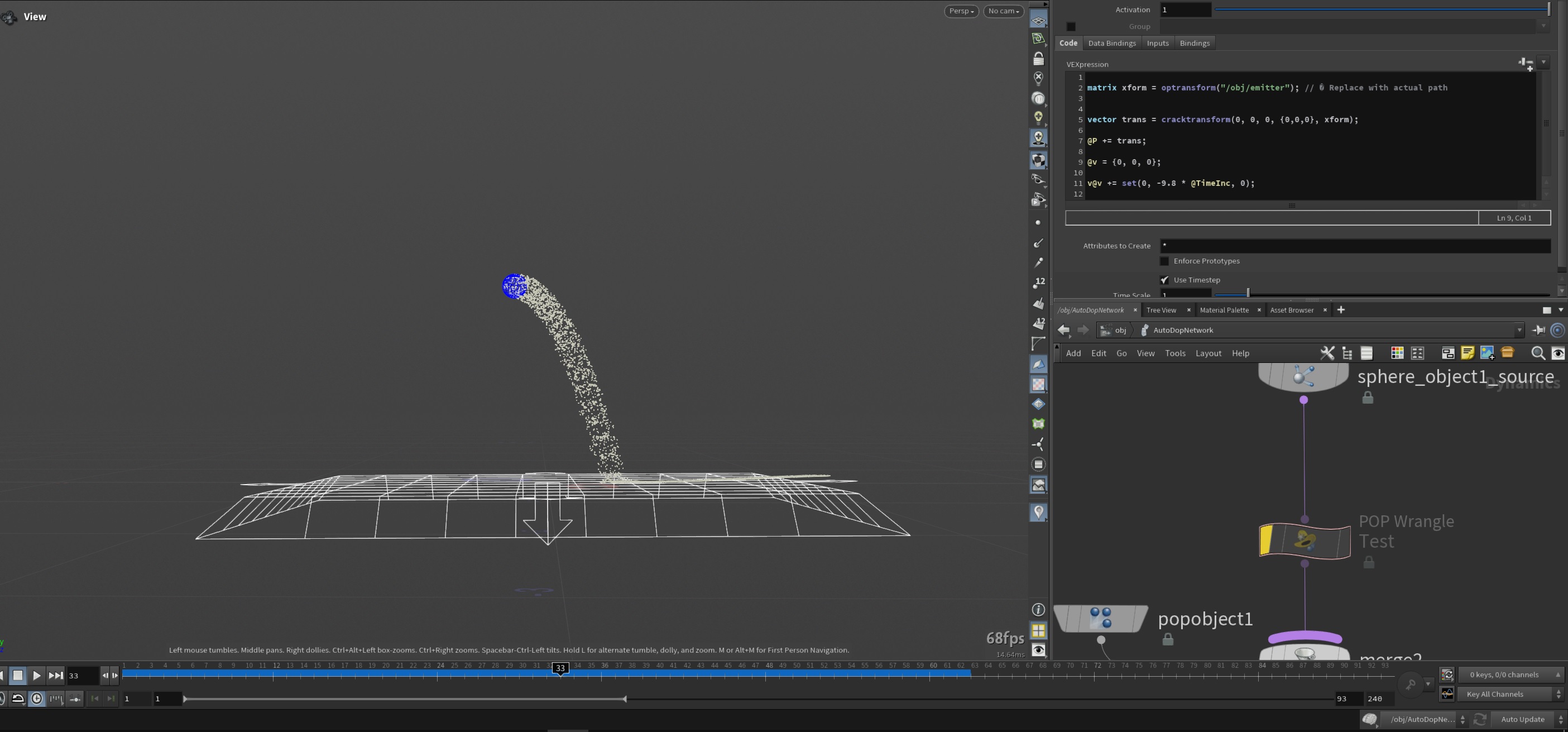

Ultraman Posted April 29 Share Posted April 29 Hey everyone, I'm trying to make particles fall straight down in world space while the emitter is moving. I remember Unity has a similar concept with world/local simulation space — is there an equivalent in Houdini? My input animation is quite fast, and the ground is moving too . Is there an alternative approach to decouple the emitter's motion from the particles ? Thanks in advance! Local space Move.hip Quote Link to comment Share on other sites More sharing options...
hannes603 Posted April 29 Share Posted April 29 untitled.mp4 dop_pop_absolut_transform.hip 1 Quote Link to comment Share on other sites More sharing options...
Ultraman Posted April 29 Author Share Posted April 29 Thank you is nice way - but the problem is both of my input have different animation - I can't switch my source animation to the Collision - Quote Link to comment Share on other sites More sharing options...
hannes603 Posted April 30 Share Posted April 30 (edited) untitled.mp4 not really sure what you mean it should work pretty easy also with two anims please feel free to try and play arroundsimple.hip Edited April 30 by hannes603 1 Quote Link to comment Share on other sites More sharing options...
