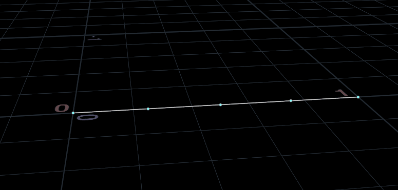

sipi Posted May 30 Share Posted May 30 4 hours ago, sebastienlevieux said: Hello guys, I tried to create an animation with a curve based on this draw, point moves sequentially toward the next one, like a folding curtain that retracts point by point. Each point can only move once the previous one has reached its position, and they must never overlap... here is my file.. if you can take a look or if you have any idea for something better Image: point 1 goes to point 2, then point 1 and 2 go toward point 3....etc...Thanks for helping. test_anim.hiplc 101.3 kB · 1 download I'm not proud of this definitely not the best approach, (especially that it doesn't stop at the end ) but maybe can give you ideas. curtain_thingy.hiplc 1 Quote Link to comment Share on other sites More sharing options...

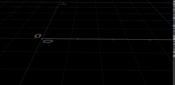

sebastienlevieux Posted May 31 Author Share Posted May 31 12 hours ago, sipi said: I'm not proud of this definitely not the best approach, (especially that it doesn't stop at the end ) but maybe can give you ideas. curtain_thingy.hiplc 138.55 kB · 2 downloads Thanks for your setup, it looks great! But I’m not seeing the same behavior on my end, in my screenshot, the points are overlapping, which doesn’t happen in your video. Quote Link to comment Share on other sites More sharing options...

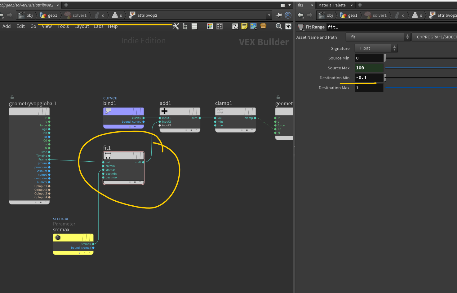

sipi Posted May 31 Share Posted May 31 2 minutes ago, sebastienlevieux said: Thanks for your setup, it looks great! But I’m not seeing the same behavior on my end, in my screenshot, the points are overlapping, which doesn’t happen in your video. Ah sorry, play with this parameter, set it for example -0.1. (i must have changed it after the gif making accidentally) But i want to emphasize that this method is not the best overall. Quote Link to comment Share on other sites More sharing options...
sebastienlevieux Posted May 31 Author Share Posted May 31 4 minutes ago, sipi said: Ah sorry, play with this parameter, set it for example -0.1. (i must have changed it after the gif making accidentally) But i want to emphasize that this method is not the best overall. But it work fine! Thank you for sharing your setup. Quote Link to comment Share on other sites More sharing options...
sipi Posted May 31 Share Posted May 31 Just now, sebastienlevieux said: But it work fine! Thank you for sharing your setup. Yeah, but only works on straigth line @Aizatulin's file is awesome! 2 Quote Link to comment Share on other sites More sharing options...
