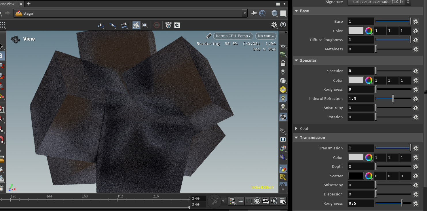

hannes603 Posted June 3 Share Posted June 3 does anyone knowrefractionTest.hip how to blur refraction in karma i have to miss something big here? thanks Quote Link to comment Share on other sites More sharing options...
tamagochy Posted June 3 Share Posted June 3 Transmission roughness do this Quote Link to comment Share on other sites More sharing options...
hannes603 Posted June 4 Author Share Posted June 4 15 hours ago, tamagochy said: Transmission roughness do this nope it blurs only kind ofthe surface. dispersion does it kind of but it adds colors which i dont really want Quote Link to comment Share on other sites More sharing options...
sipi Posted June 4 Share Posted June 4 (edited) Reset Index of Refraction parm under the Specular section. It affects Transmission as well. In your file it is set to 1. That's why Transmission Roughness do nothing. If this is what you want: Edited June 4 by sipi adding a picture Quote Link to comment Share on other sites More sharing options...
