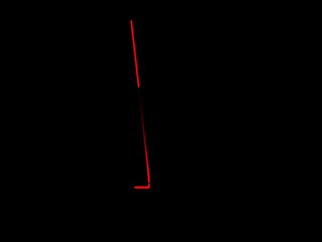

sorry i missed the material library constant has a point alpha... it was a problem with my values ... but please tell me what's happening here?!
The alpha ramp value somehow loops?! ... i ve set a linear ramp for alpha (1 to 0) with the lookup $SPEED
thx
Edited by hatrick
yes, it loops and the same for color
you need to use clamp($SPEED,0,1) as Lookup if you do not want it to
