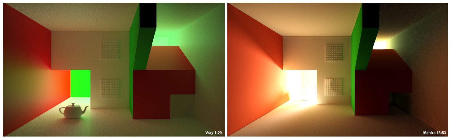

renderfan Posted March 17, 2012 Author Share Posted March 17, 2012 Thank you Erik for reply! I did test with Vray and Mantra to match output on both renderer. It is simple scene with one geometry light with texture and only diffuse shader. I have problem to get same result. With Mantra area around light is to bright and I do not see texture on light. If I turn down light intensity then the render is to dark. Erik, I think you maybe have same problem with your scene HERE Any help welcome. Thank you! Quote Link to comment Share on other sites More sharing options...

renderfan Posted March 21, 2012 Author Share Posted March 21, 2012 I did new test with comparing Vray and Mantra in regards to THIS post. I use file and settings for render from Side Effects site here: http://www.sidefx.com/index.php?option=com_forum&Itemid=172&page=viewtopic&t=20382&highlight=pbr http://www.sidefx.com/index.php?option=com_forum&Itemid=172&page=viewtopic&t=21548&postdays=0&postorder=asc&highlight=pbr&start=0 Mantra is much slower in my test and it is still noise. I really like Mantra but for GI i think it is simple to slow. Any tips and tricks are appreciated. Thank you!!! Quote Link to comment Share on other sites More sharing options...

petz Posted March 21, 2012 Share Posted March 21, 2012 Thank you Erik for reply! I did test with Vray and Mantra to match output on both renderer. It is simple scene with one geometry light with texture and only diffuse shader. I have problem to get same result. With Mantra area around light is to bright and I do not see texture on light. If I turn down light intensity then the render is to dark. Erik, I think you maybe have same problem with your scene HERE Any help welcome. Thank you! i guess your light-intensity is outside the 0-1 range and thats the reason why you get these overexposed areas around your light. you should render out the image in 32 bit and do tonemapping and color grading in comp. for previews you could use a simplified tonemapper to get a better feeling how the final image will look like. file is attached. hth. petz tonemapping.hipnc 1 Quote Link to comment Share on other sites More sharing options...
