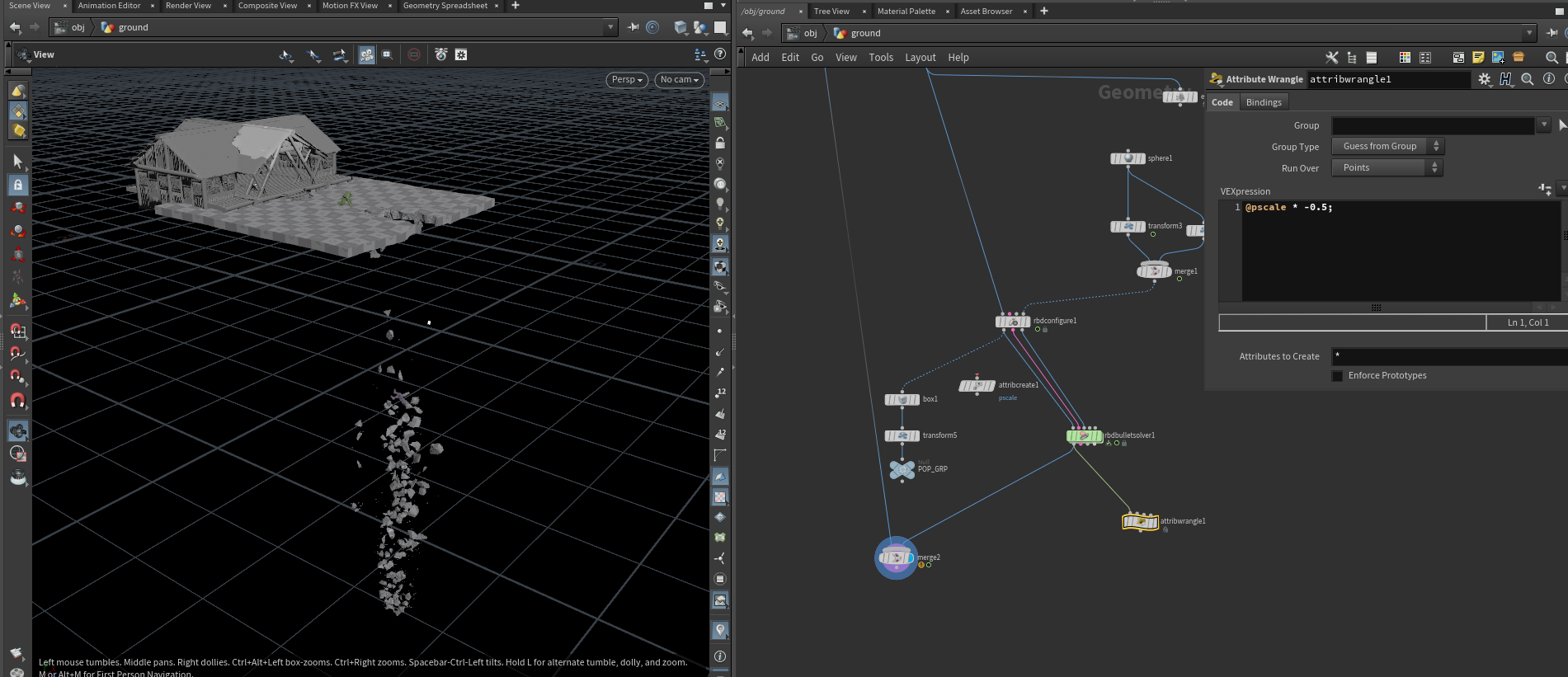

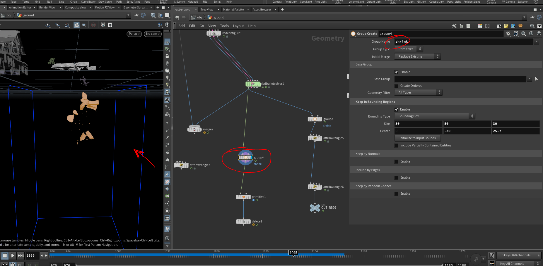

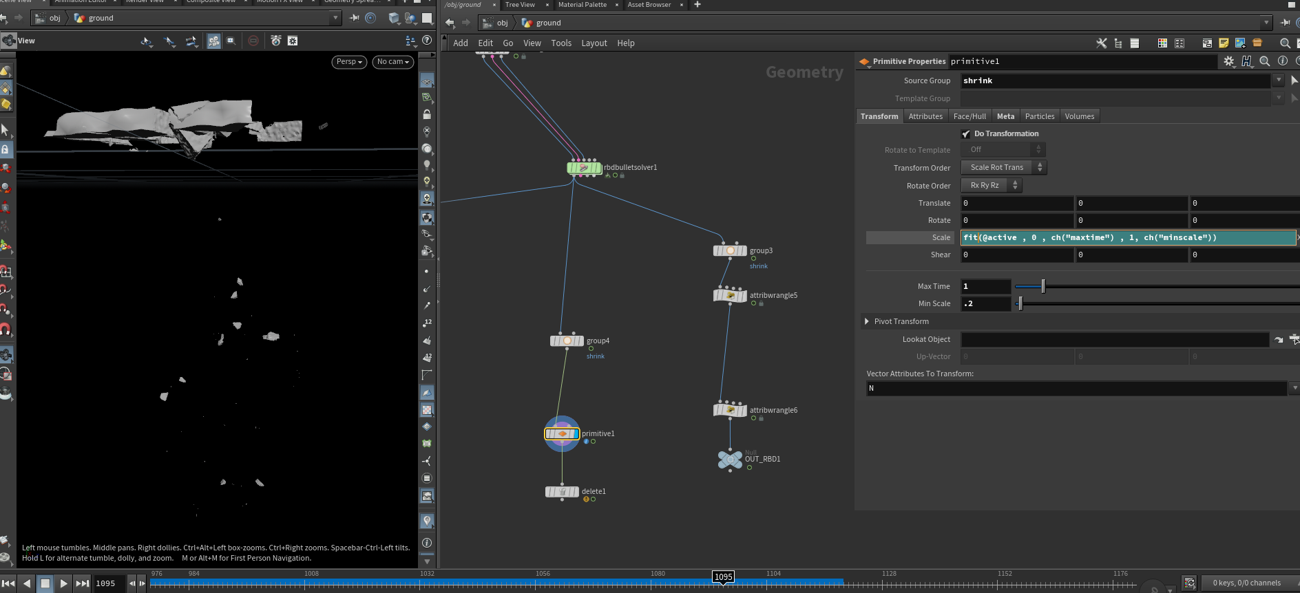

anthonymcgrath Posted April 29 Author Share Posted April 29 44 minutes ago, hannes603 said: the copy point node is using the pscale to scale the geo down you just need to center each piece before. you can maybe also just mix the scale with the vop thats even a bit easier maybe... p_scale_pop_rbd_after_sim_reapply_rbd_setup_02.hip thankyou for this - i've also been looking at another method that used a sop solver and multi solver and i decided to try that out... then i realised that might be overkill... so i added a group node beneath my fracturing pieces.... and a primitive sop with the expression that was in that @ParticleSkull explanation... this is kinda doing what i would like but the pieces just instantly shrink when they enter the bounding box of the group node.... if i could get them to shrink down with this method it would make things so easy for me Quote Link to comment Share on other sites More sharing options...

hannes603 Posted April 29 Share Posted April 29 check you spreadsheet there might be something wrong with your scaling attribs.. 1 Quote Link to comment Share on other sites More sharing options...
anthonymcgrath Posted April 29 Author Share Posted April 29 1 hour ago, hannes603 said: check you spreadsheet there might be something wrong with your scaling attribs.. yeah for some reason the pieces are just "popping" to a different size as soon as they enter the group node... and they revert to their original size when they fall through the group node. I'm guessing this is why people use the sop solver or do this sort of thing within the bulletsolver? So it can be itereated on each frame over time? tried all sorts of things - its really frustrating that its so complex to do after a simulation Quote Link to comment Share on other sites More sharing options...
