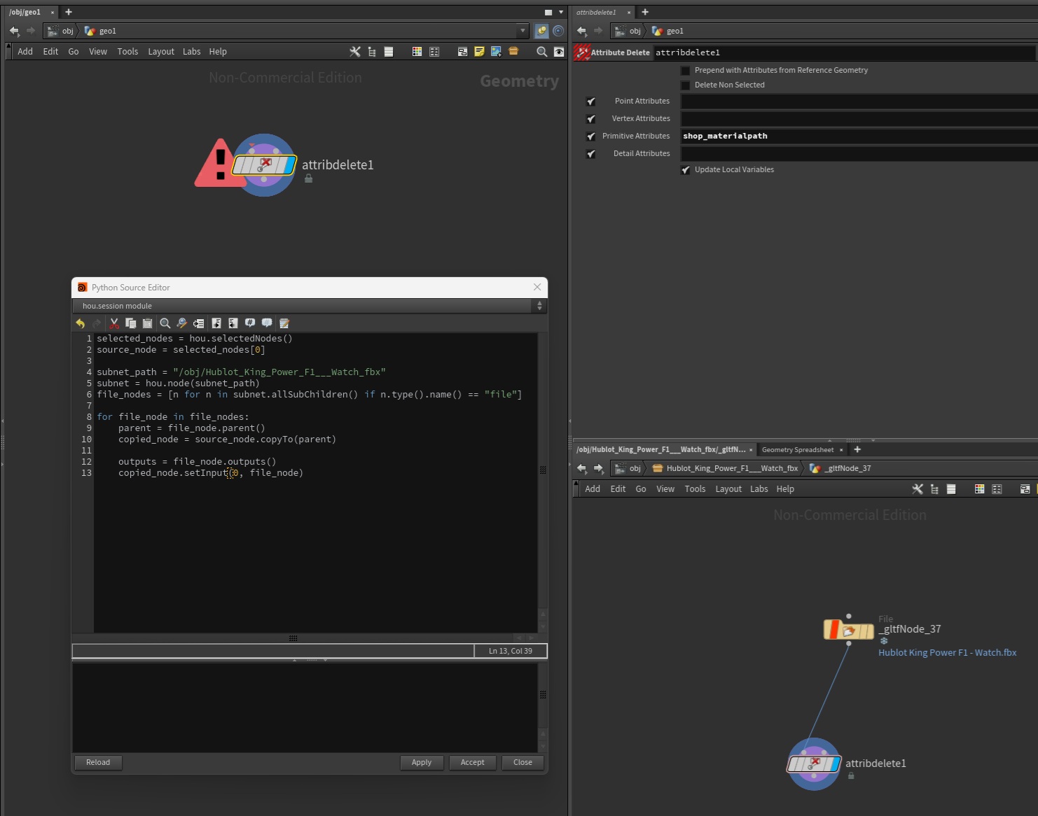

1. Create an attribdelete with required parameters
2. Windows > Python Source Editor
selected_nodes = hou.selectedNodes()
source_node = selected_nodes[0]
subnet_path = "/obj/Hublot_King_Power_F1___Watch_fbx"
subnet = hou.node(subnet_path)
file_nodes = [n for n in subnet.allSubChildren() if n.type().name() == "file"]
for file_node in file_nodes:
    parent = file_node.parent()
    copied_node = source_node.copyTo(parent)
    outputs = file_node.outputs()
    copied_node.setInput(0, file_node)
3. Select attribdelete to copy to
4. Appy script
It will copy-paste selected node into each node in Hublot_King_Power_F1___Watch_fbx subnetwork and attach it to file* node

Thank you!! Wow! This worked quite well! Is it also possible to set the display flag to attribdelete inside each of the parts in bulk too?

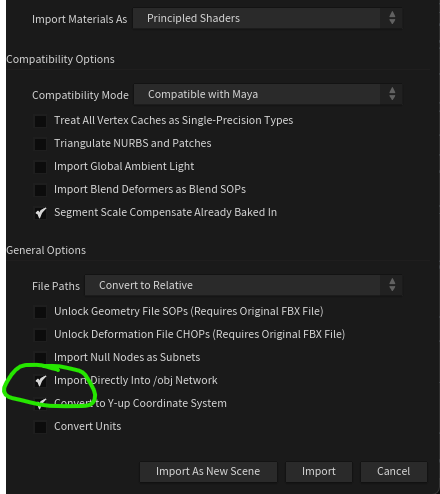

Also...while importing the fbx, I came across a better import option that places materials inside the existing matnet instead of creating a new one inside OBJ network.
It also creates all parts directly at the OBJ level, rather than nesting everything inside a subnet (which is what my earlier method was doing).
Would it be possible for you to tweak your Python script to work with this setup instead?
