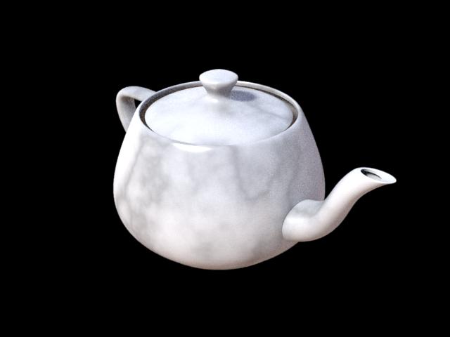

calix Posted July 30, 2010 Share Posted July 30, 2010 Thanks for the tip Marc! Texture is good now, but it renders only into the red channel with your shader...see the image. When I use the PTexture node in a Material Shader Builder it renders correctly. teapot_good.hip Quote Link to comment Share on other sites More sharing options...
Marc Posted July 31, 2010 Share Posted July 31, 2010 yeah it's weird, it was rendering fine for me at first and then I changed something and it just rendered into the red channel. I didn't have time to troubleshoot it . Besides, red teapots are cool... Quote Link to comment Share on other sites More sharing options...
calix Posted August 1, 2010 Share Posted August 1, 2010 maybe the ptex support in shaders without the ptexture node is buggy??? Quote Link to comment Share on other sites More sharing options...

crunch Posted August 10, 2010 Share Posted August 10, 2010 I also have problems with the ptex sample files. The textures don't get assigned correctly... The bunny is intended to be rendered as a Loop subdivision surface. Mantra doesn't support this type of subdivision surface. If you render as polygons, prman doesn't render the texture correctly either. It does seem that the polygons of a .obj file import need to be reversed to render correctly though. I've attached an updated version of the teapot example from the ptex web site. Hope this helps (there's a .hip file in there). h_teapot.zip Quote Link to comment Share on other sites More sharing options...
