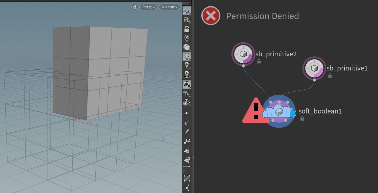

zarralax Posted May 13, 2019 Share Posted May 13, 2019 (edited) Does DM with H17 patch not work in H17.5? I finally was able to update to H17.5 and tried a simple soft boolean test and I get an error in the soft boolean node (only simple mode works). I can't look at the error "Permission Denied". I have the DM 1.0 (with possibility with updating) version. Thanks. closest chevron to me Edited May 13, 2019 by zarralax added image Quote Link to comment Share on other sites More sharing options...
hallogero@gmail.com Posted May 13, 2019 Share Posted May 13, 2019 14 hours ago, zarralax said: Does DM with H17 patch not work in H17.5? I finally was able to update to H17.5 and tried a simple soft boolean test and I get an error in the soft boolean node (only simple mode works). I can't look at the error "Permission Denied". I have the DM 1.0 (with possibility with updating) version. Thanks. closest chevron to me I can conform that DM 1.0 gives me an error in Houdini 17.5. I have installed the patch for 17.0. Quote Link to comment Share on other sites More sharing options...
Alexey Vanzhula Posted May 13, 2019 Author Share Posted May 13, 2019 Hi guys. Sorry for late answer. It's known issue with H17.5. DM 1.5, which works only with H17.5, is in last beta stage. Please wait a bit. 1 1 Quote Link to comment Share on other sites More sharing options...
