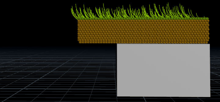

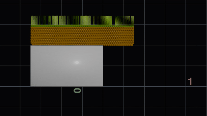

Masoud Posted Tuesday at 04:49 PM Share Posted Tuesday at 04:49 PM Hi everyone, I'm trying to copy some grass onto the top of my Vellum grains simulation. However, the grass blades aren't aligning with the direction of the grains — they always point straight up instead of following the grains' orientation. Does anyone know how I can make the grass follow the grains' axis properly? Thanks in advance for your help! Grain Grass_01.hip Quote Link to comment Share on other sites More sharing options...

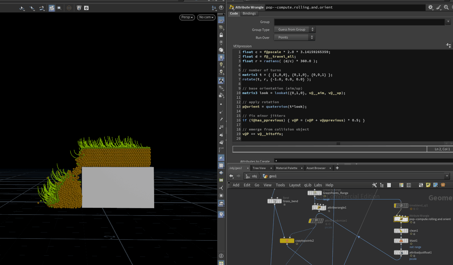

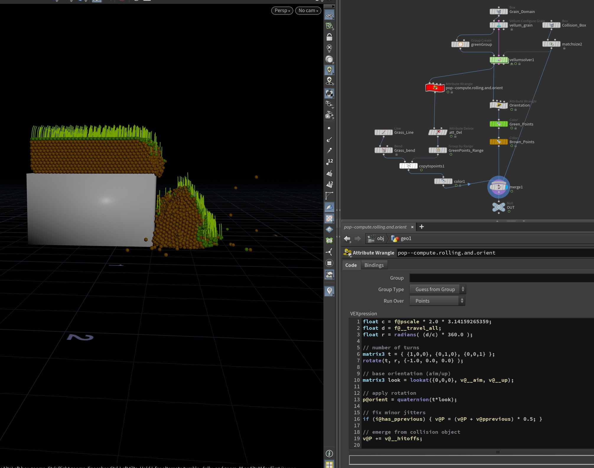

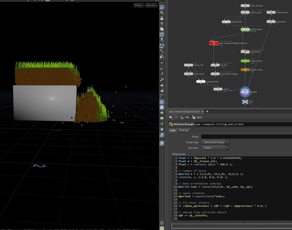

Librarian Posted Tuesday at 10:31 PM Share Posted Tuesday at 10:31 PM Check rolling debris file in qLib Master files (workFlow) . You need orient Att.. @Masoud Quote Link to comment Share on other sites More sharing options...

Librarian Posted 23 hours ago Share Posted 23 hours ago I just used last vex after simulation that you have in That file . For more advance Trick and Study if you search Grains orientation you gonna find some Studies on that Topic and Vex Codes. @Masoud Quote Link to comment Share on other sites More sharing options...
Masoud Posted 18 hours ago Author Share Posted 18 hours ago (edited) I opened the "rolling_debris.hip" file and confirmed that the POP Solver already aligns particle orientation to the surface correctly, without requiring any additional code. What I actually need is the same behavior for Vellum Grains, but it seems that Vellum doesn't orient the particles properly by default. I searched for "Grains Orientation" but couldn’t find any helpful tips. Since the Vellum solver doesn’t compute orientation by default, I manually applied an initial orient attribute before the solver. This stabilized the orientation, but now I need it to align properly with the animation. Edited 18 hours ago by Masoud Quote Link to comment Share on other sites More sharing options...
Masoud Posted 17 hours ago Author Share Posted 17 hours ago I added the "up" and "orient" attributes before sim, and included these lines of code after it. The alignment has a little improved, but it's still not exactly what I need: vector axis = v@v * v@up; float angle = @Time * $PI; vector4 spin = quaternion(angle, axis); @orient = qmultiply(@orient, spin); The issue is that the grain's orientation resets to its initial state after they reach to the rest (zero velocity). Any ideas to improve it? Quote Link to comment Share on other sites More sharing options...
