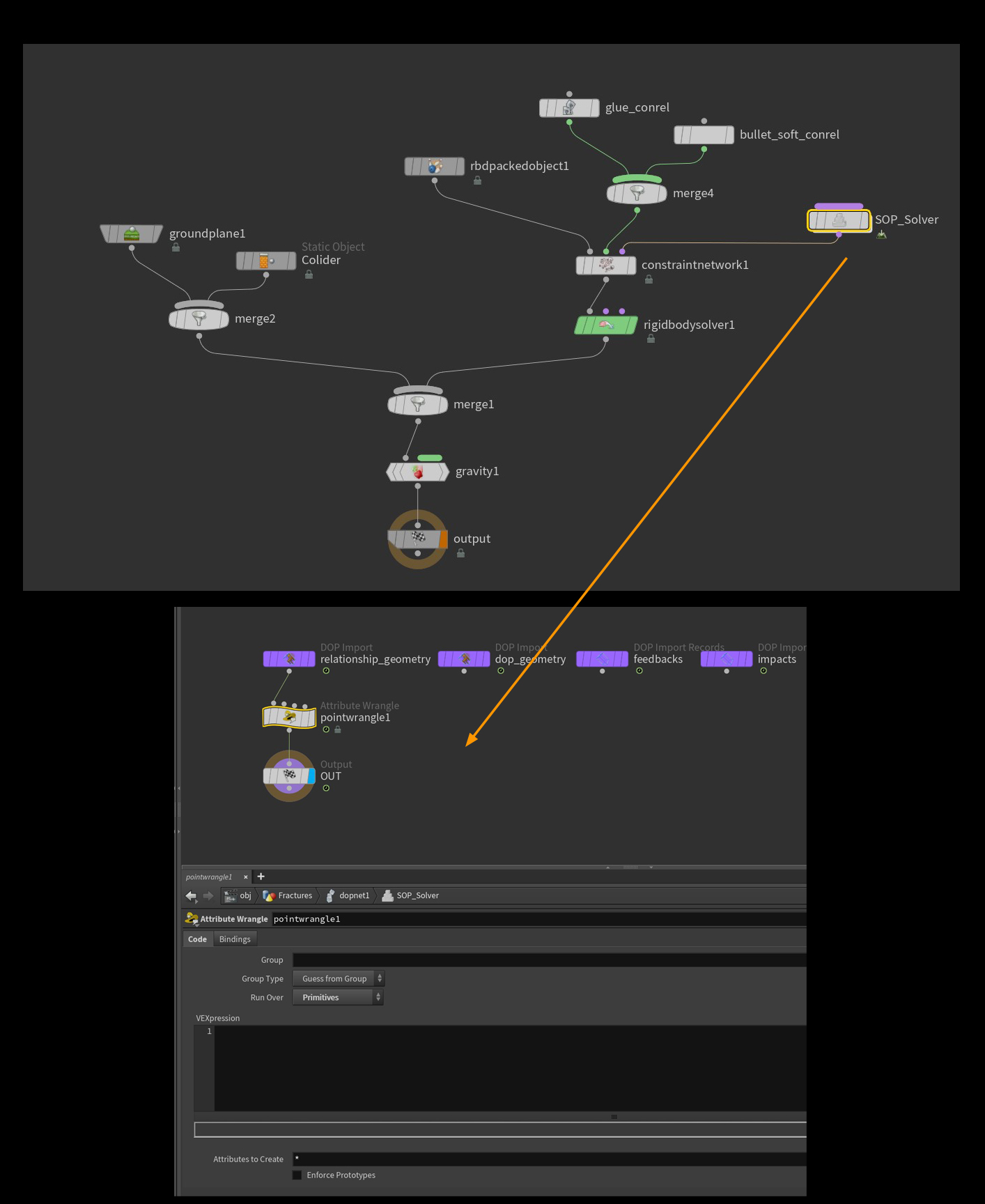

Hi everyone,
In a rigid-body simulation, I'd like to break constraints if the RBDs go above 1.5 in the Y position (i.e., @P.y > 1.5).
I've added a SOP Solver to the last input of the Constraint Network DOP, but I'm not sure how to access the Y position of the RBDs inside the solver.
Any ideas on how to reference the RBD positions correctly?
Thanks in advance for your help!
Posted (edited)
inside SOP Solver you can apply 1 in 2 options:
1. Merge the dop_geometry data into second input for Y position per step of the RBDs (select by name or DOP id to select the animated geo)
2. If the animated RBD geometry ahead at SOP. Use a merge node, merge the animated geo into the SOP Solver
Both give you animated Y position of the animated geometry. Input that to 2nd input of the VEX wrangle to apply operation on primitive.
