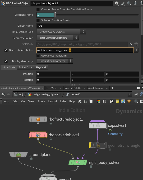

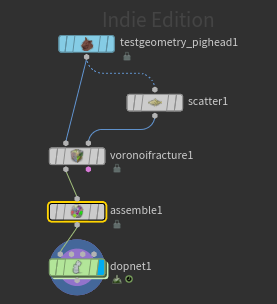

Atom Posted August 10 Share Posted August 10 It is easier to control if you used packed RBDs. Then you can overwrite the v@v attribute. Add an Assemble dop before the dopnetwork and check Create Packed Primitives. Quote Link to comment Share on other sites More sharing options...

paranoidx Posted August 31 Share Posted August 31 Use the Bullet SOP Solver it’s a quicker, cleaner setup than a classic DOP workflow. Configure your pieces with RBD Configure to pack fragments and set RBD properties; even when simming in DOPs, pre-process with this node before the solver. To inject velocity (@v) mid-sim, place a SOP Solver inside the DOP network. In the file, dive into the RBD SOP and add a SOP Solver at Post-Solve; inside it, an Update v wrangle updates per-point velocities on the RBD packed pieces. add_v_postsolve_rbd_v1a.hiplc Quote Link to comment Share on other sites More sharing options...
