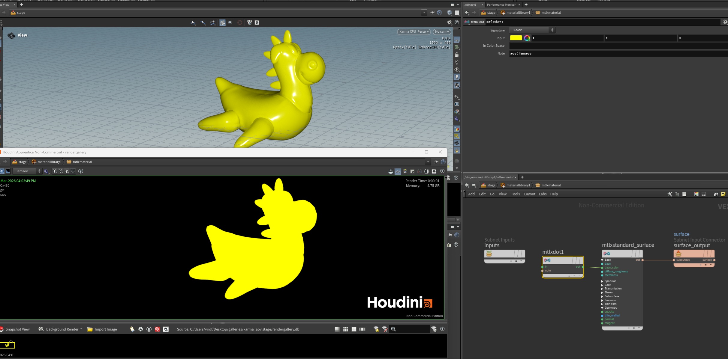

kiryha Posted 7 hours ago Share Posted 7 hours ago How to create custom AOVs in Karma? I followed the documentation, but it does not work. Am I missing something? Here is the scene: karma_aov.zip Created new Extra Render Var, named XXX, trying to output diffuse_color from subnet1 material. Quote Link to comment Share on other sites More sharing options...

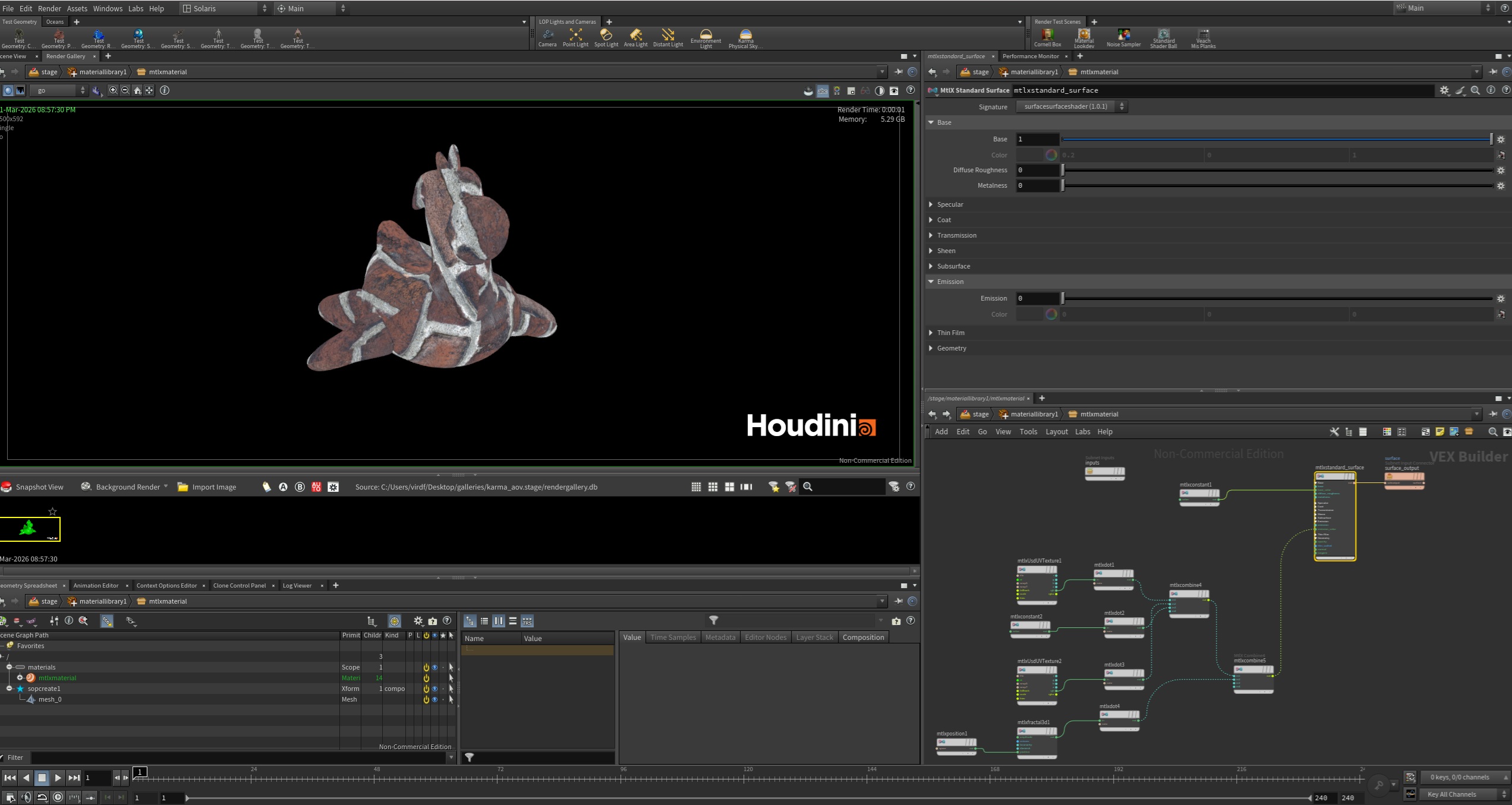

Librarian Posted 5 hours ago Share Posted 5 hours ago AOV_v04 using for mine Projects no errors ..Tricks AOVs_H20_v05.hip AOVs_v04Srle.hiplc 2 Quote Link to comment Share on other sites More sharing options...
fencer Posted 5 hours ago Share Posted 5 hours ago Try with mtlxdot Quote Link to comment Share on other sites More sharing options...
kiryha Posted 5 hours ago Author Share Posted 5 hours ago @Librarian That is a very complex setup I was not able to figure out what I should adjust in mine... @fencer Tried mtlxdot instead of karma_aov, did not work... Quote Link to comment Share on other sites More sharing options...
fencer Posted 3 hours ago Share Posted 3 hours ago dot seems ok 1 Quote Link to comment Share on other sites More sharing options...
kiryha Posted 13 minutes ago Author Share Posted 13 minutes ago (edited) @fencer Thank you! The "aov:" was the trick Edited 7 minutes ago by kiryha Quote Link to comment Share on other sites More sharing options...
