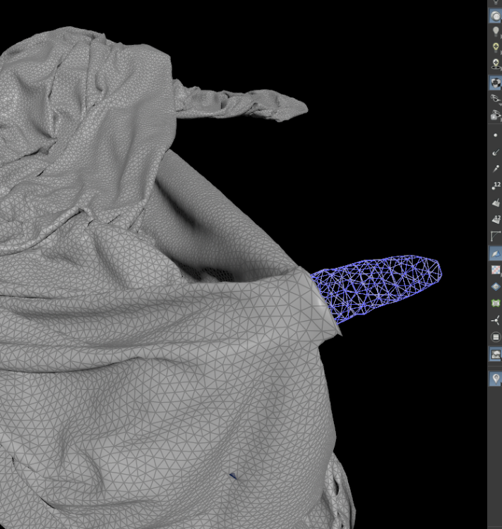

hannes603 Posted May 23, 2025 Share Posted May 23, 2025 (edited) untitled.mp4 the problem is that the blue tip is pushing through the cloth becouse of tension in the cloth- how can i fix it ? i already have super high substeps and collision passes... thanks! Edited May 23, 2025 by hannes603 Quote Link to comment Share on other sites More sharing options...

hannes603 Posted May 23, 2025 Author Share Posted May 23, 2025 6 minutes ago, fencer said: Timeblend on collision geometry as well? thanks. i already tryied it. also eneabling re evaluation on the collidier did not helped Quote Link to comment Share on other sites More sharing options...

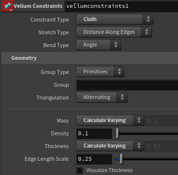

tamagochy Posted May 23, 2025 Share Posted May 23, 2025 Maybe try to increase thickness of the cloth or add dynamic glue constraint between collider and cloth Quote Link to comment Share on other sites More sharing options...
hannes603 Posted May 24, 2025 Author Share Posted May 24, 2025 17 hours ago, tamagochy said: Maybe try to increase thickness of the cloth or add dynamic glue constraint between collider and cloth i tried to double the thinkness.. doesnt work ether it still pushes through... Quote Link to comment Share on other sites More sharing options...
Librarian Posted May 24, 2025 Share Posted May 24, 2025 try if not already !! and calculate velocity on that collision Maybe. Quote Link to comment Share on other sites More sharing options...
hannes603 Posted May 25, 2025 Author Share Posted May 25, 2025 19 hours ago, Librarian said: try if not already !! and calculate velocity on that collision Maybe. treid to add the veloctiy to the collider did not work.. the glue constraint im not sure bec it changes everything and i cant get the desired effect anymore with it .. so maybe the animator have to reanimate the tale bec i am totally clueless what to do .. Quote Link to comment Share on other sites More sharing options...
fencer Posted May 25, 2025 Share Posted May 25, 2025 So we need HIP, you can bake geo inside and share if permitted by prod. Quote Link to comment Share on other sites More sharing options...
tamagochy Posted May 26, 2025 Share Posted May 26, 2025 Radical: retime animation to slow twice, sim than retime back! Quote Link to comment Share on other sites More sharing options...
hannes603 Posted May 27, 2025 Author Share Posted May 27, 2025 16 hours ago, tamagochy said: Radical: retime animation to slow twice, sim than retime back! thanks thats a good idea but the sim already takes couple of hours 250 frames... but for now the animator did some changes to the animation so the problem is kind of solved for now Quote Link to comment Share on other sites More sharing options...
