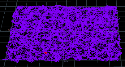

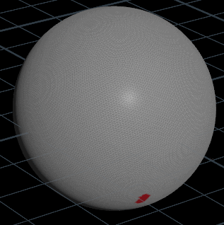

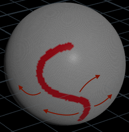

GlennimusPrime Posted June 19 Share Posted June 19 (edited) This one is a little tricky. I have seen many tutorials showing how to expand / grow an attribute from a start point outward, but I'm struggling with expanding an animated attribute. I have this sphere that accumulates a mask attribute over time, leaving a trail where another object has moved across the surface: I'd like that mask attribute to expand / grow outwards until it covers the whole sphere. File attached: attribute_spread.hiplc Edited Wednesday at 11:00 AM by GlennimusPrime Quote Link to comment Share on other sites More sharing options...

konstantin magnus Posted June 19 Share Posted June 19 Hi @GlennimusPrime, you could measure and over time remap the surface distance from the mask. attribute_spread_KM.hiplc Quote Link to comment Share on other sites More sharing options...

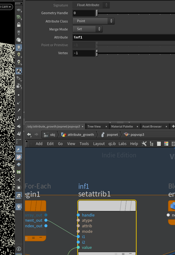

GlennimusPrime Posted Sunday at 10:29 PM Author Share Posted Sunday at 10:29 PM (edited) Thanks @Librarian @konstantin magnus @hannes603 all really great examples! Just to throw a spanner in the works, one pretty major issue I forgot to mention was the points I'm working with are disconnected and animated.. I managed to get @hannes603 example working on an animated static point count object by swapping the inputs of the vop inside the solver: But unfortunately this does not work when I have a changing point count when working with particles - I tried copying the attribute from previous frame onto the current frame using point ID to match attributes, but the entire object is filled almost instantly with the infected attribute. Any ideas when working with animated changing point count objects? Updated file attached: attribute_spread_v2_animated.hiplc Edited Sunday at 10:38 PM by GlennimusPrime 1 Quote Link to comment Share on other sites More sharing options...

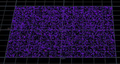

hannes603 Posted Monday at 09:24 AM Share Posted Monday at 09:24 AM infection on changing point count is usually no problem . it should work directly like here right untitled.mp4 pop_infection_on_changing_point_count.hiplc Quote Link to comment Share on other sites More sharing options...

Librarian Posted Tuesday at 08:02 AM Share Posted Tuesday at 08:02 AM @GlennimusPrime It works just make changes in this section inside POP VOP to inf1 Quote Link to comment Share on other sites More sharing options...

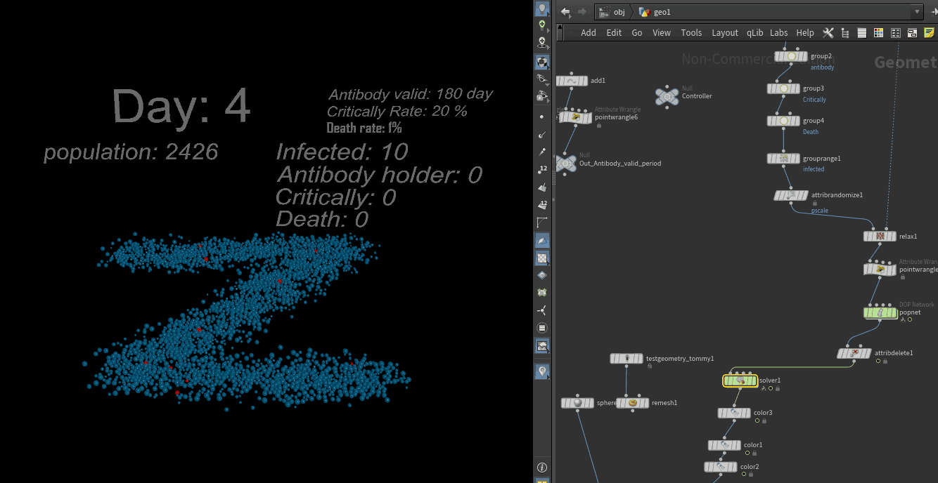

Librarian Posted Wednesday at 08:15 AM Share Posted Wednesday at 08:15 AM (edited) On 6/23/2025 at 11:14 PM, GlennimusPrime said: I'm unable to install any otls at the studio I'm working. 3 hours ago, GlennimusPrime said: One last thing, what if I wanted to do this as a post-sim infection spread? Studio ??? Talk to your manager right away and give these guys a job @hannes603 @konstantin magnus if they need a job.. Find Qiita website . !Advent Houdini 2020! you have Files for Infect and very Nice tricks for making those effects and much more using same Logic . Then(TIP) When you have Full Code that Works in Houdini you can Make anything in chatgpt(reverse and investigete) Now days. Have a nice Day . Edited Wednesday at 08:55 AM by Librarian 3 Quote Link to comment Share on other sites More sharing options...

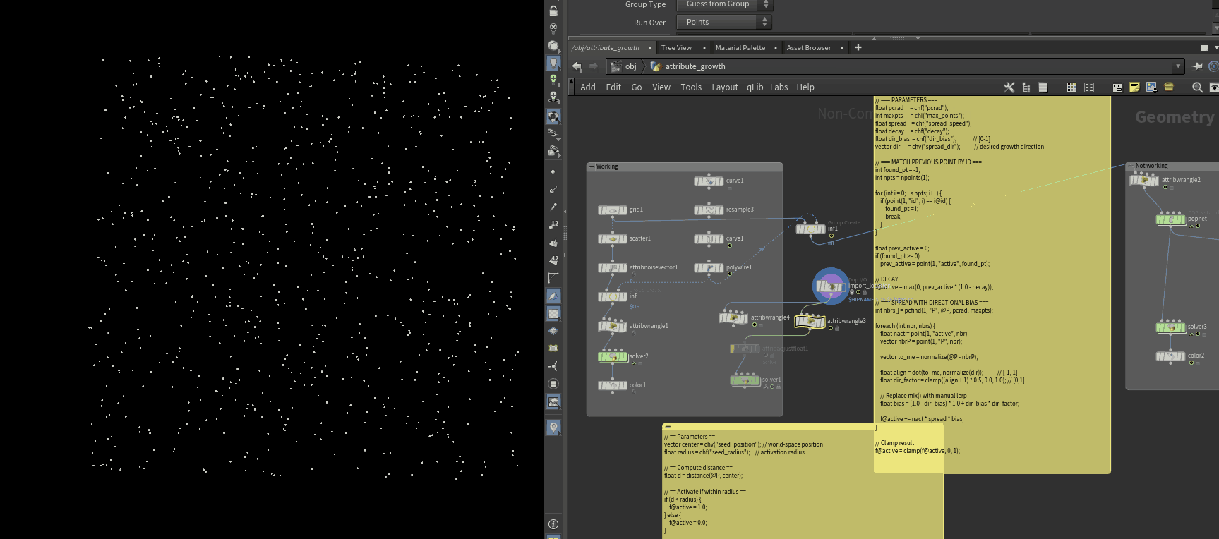

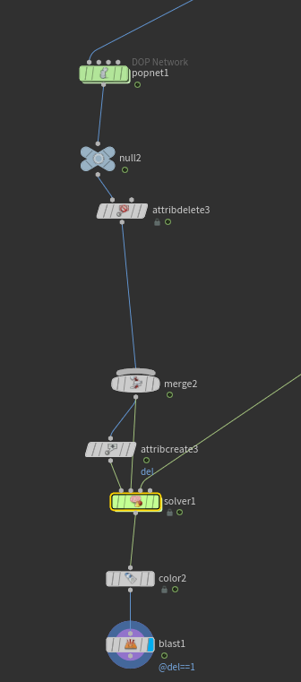

hannes603 Posted 22 hours ago Share Posted 22 hours ago (edited) sure you can also do it post solve pretty much the same way .. you only need to accumulate all particles in the solver and remove them afterwards.. otherwise id hase no corrosponding ptnum untitled.mp4 infection_with_changing_point_count_post_solve_simple_improved.hip Edited 21 hours ago by hannes603 1 1 Quote Link to comment Share on other sites More sharing options...

GlennimusPrime Posted 3 hours ago Author Share Posted 3 hours ago 18 hours ago, hannes603 said: sure you can also do it post solve pretty much the same way .. you only need to accumulate all particles in the solver and remove them afterwards.. otherwise id hase no corrosponding ptnum Amazing, that's it! Thanks so much @hannes603 Really appreciate all the effort both you and @Librarian have gone through here to tackle this one. Goes to show the greatness of the Houdini community. Many thanks. Quote Link to comment Share on other sites More sharing options...
