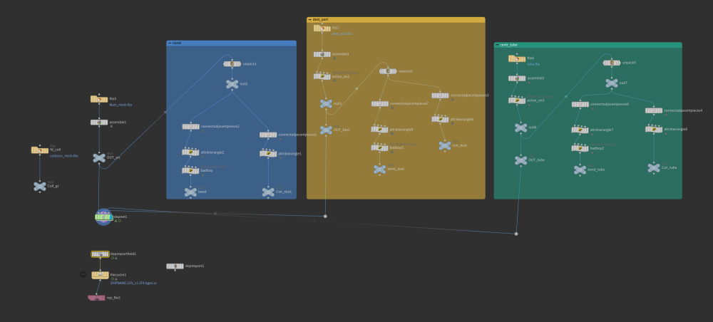

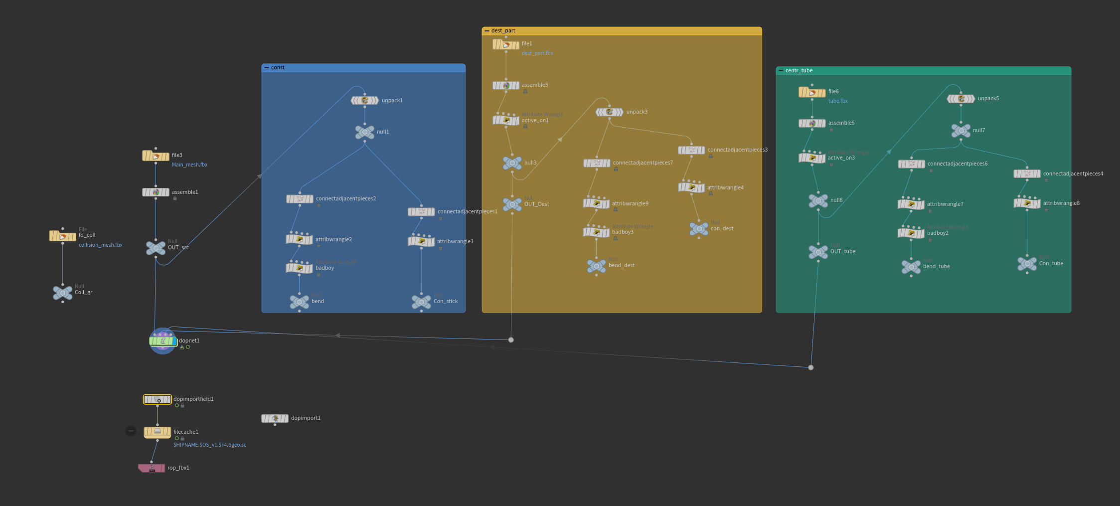

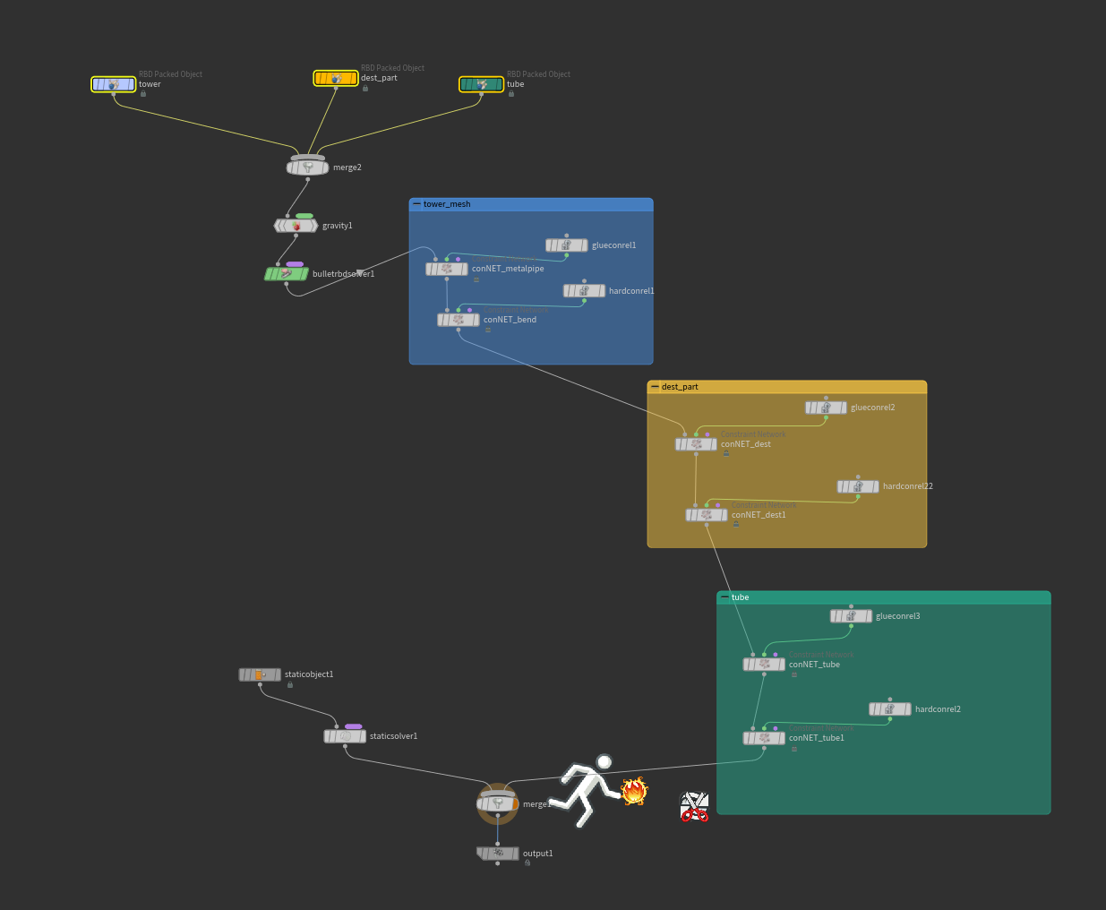

racdew Posted Thursday at 09:03 AM Share Posted Thursday at 09:03 AM (edited) Hi everyone! I have a problem with exporting the assembled animation to Maya in fbx format The animation of the tower itself was built using this tutorial The main problem with outputting animations in fbx format: -The animations are in the cache and not cached with the keys exposed as I have done before through the SOP of the network -And for some reason the model is broken into separate pieces that were triangulated Maybe someone has encountered a similar problem and can tell you how to solve it Attached screenshots and source of my project Edited yesterday at 10:07 AM by racdew Quote Link to comment Share on other sites More sharing options...

racdew Posted yesterday at 10:02 AM Author Share Posted yesterday at 10:02 AM 11 hours ago, Sepu said: Do not use .fbx to export back to Maya, either use an .abc or .usd I need only fbx for the project, alembic is not stored in Maya file only in cache, on the output I want to get from this baked animation on transforms with keys on timeline Quote Link to comment Share on other sites More sharing options...
tamagochy Posted yesterday at 04:59 PM Share Posted yesterday at 04:59 PM There is no keys in simulation and you cant get them with export. If you need keys per each piece you can bake them after simulation and export baked geometry 1 Quote Link to comment Share on other sites More sharing options...
racdew Posted 23 hours ago Author Share Posted 23 hours ago 2 hours ago, tamagochy said: There is no keys in simulation and you cant get them with export. If you need keys per each piece you can bake them after simulation and export baked geometry Can you tell me which nodes are responsible for this? Or at least a similar tutorial if you have one, because I have not found anything similar for my situation( Quote Link to comment Share on other sites More sharing options...
