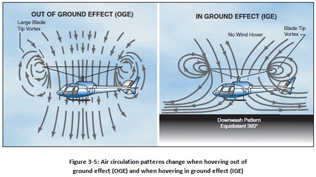

hello,How to simulate this force in the fluid...
I tried a lot of ways hard to control
The following is a reference picture
Anybody know the way please help me
thank you.
Share this post
Link to post
Here is a particle setup for helicopter dust, maybe you can modify it to produce a field? For FLIP you may want to take a look at a GasVOP for modifying the field prior to being processed by the FLIPSolver. It looks basically like an expanding circle/ring with noise.
Thank you for your reply
I saw your example,The field of the fluid was also tested.
But my effect is poor.It is difficult to keep the force field in balance
It is difficult to get details.
I am currently studying the effect of raindrop ripples.
Using a simple velocity field seems difficult to control.
I do not know what to do

Hi, I never tried this but have been gathering materials on this topic for a while.
Check those links
https://rotorcraft.arc.nasa.gov/Research/Programs/brownout.html
The simplest way that comes to my mind is to manually paint curves based on those images. Then from curve tangents generate vector field which you can use to influence your FLIP. If your helicopter is moving then parent your vector field to movement of helicopter.
Another technique to play with would be to pre-process your vector field in simple pyro simulation to make it divergence-free :)
Definitely interesting effect to research!

Hi guys,
workflow to create custom velocity volumes can be like this: create box, which will contain volume, create vector volume with volume sop (pipe the box into the node for bounds information), paint your curves and create tangent attribute using polyframe sop, use volume from attribute sop to convert tangent attribute into your vector volume. Now you should have vector volume which you can use in your flip/pop/pyro sims.
